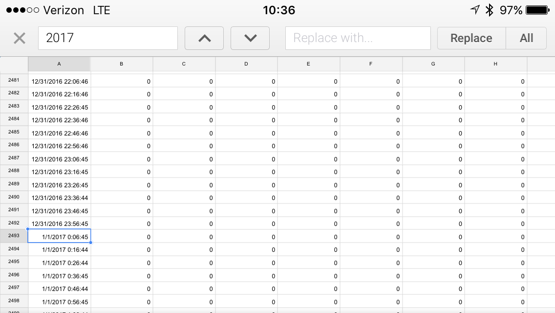

I don’t have either limitation.
As you can see on the attachment, rows > 2000 and fields >> 1.
The method I’m using also allows sheets to be created automatically. I have several devices, so I use the device name.
It’s all doable!
