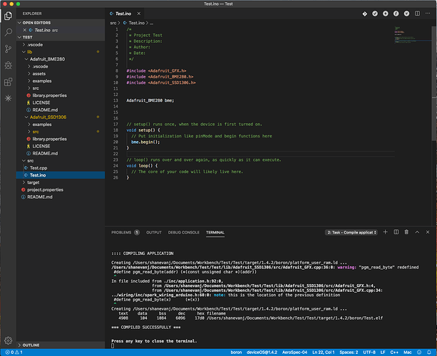

Apart from a warning, complies on my system - had to remove two files named .DS_Store in the folder you linked. Seems like you have a Work bench configratiom or installation issue ?

@shanevanj, not sure how you were able to build that project.
There clearly is an #include <Adafruit_BME280.h> in Test.ino but that library is not present in the project nor is there a dependency reference in project.properties.
However, when I run
image for Adafruit_BME280 the project builds in the cloud and locally.
Just to get rid of the ARDUINO not defined message adding #include <Arduino.h> won’t harm.

Very strange that it complied!
Added Adafruit_BME280 and compiled no errors (other than the warning for pgm_read_byte)
