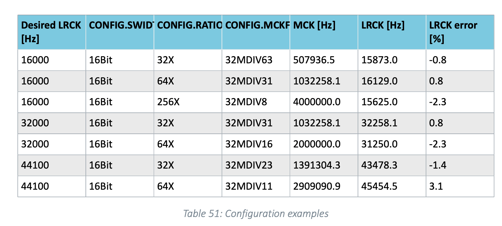

I meant this table. This is not exhaustive - there are other combinations. However it’s not possible to generate every sample frequency and width combination as some are not an even multiple.
