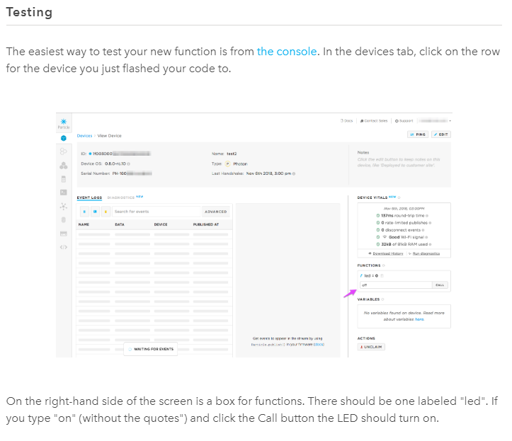

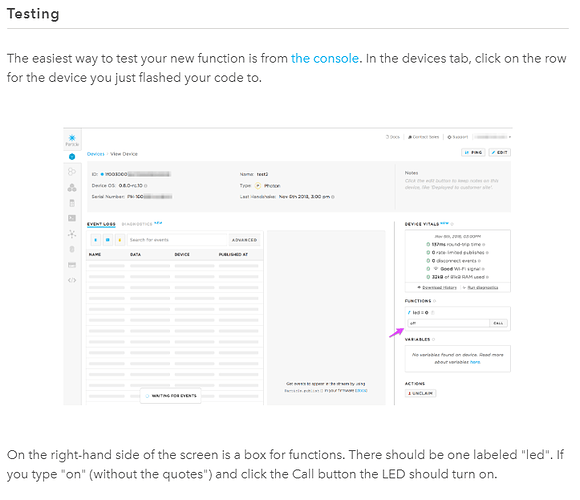

Have a look:
https://docs.particle.io/tutorials/hardware-projects/hardware-examples/photon/#control-leds-over-the-39-net
Oh, wow. Instructions!
Thanks. I knew I missed something.
Ok. I found my device id, but where do I find the access token?
Doesn’t seem to be ICCID or IMEI from the Particle Console.
The Docs Moors7 linked to shows you how to toggle the led from your Particle Console.
Have a look :wink:
https://docs.particle.io/tutorials/developer-tools/build/photon/#account-information
And, for anybody googling…
You just click the gear icon in the bottom left of the Build screen.
