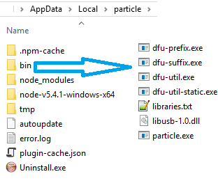

Yes, to emphasize, I’m using only Particle CLI (no cloud). I’m not speaking of any additional libraries at this point, only what came with the Arduino IDE and Particle CLI. I do not see a particle.h on my hard drive anywhere, and if I look at the directory for the .\bin\PARTICLE.EXE I see:
