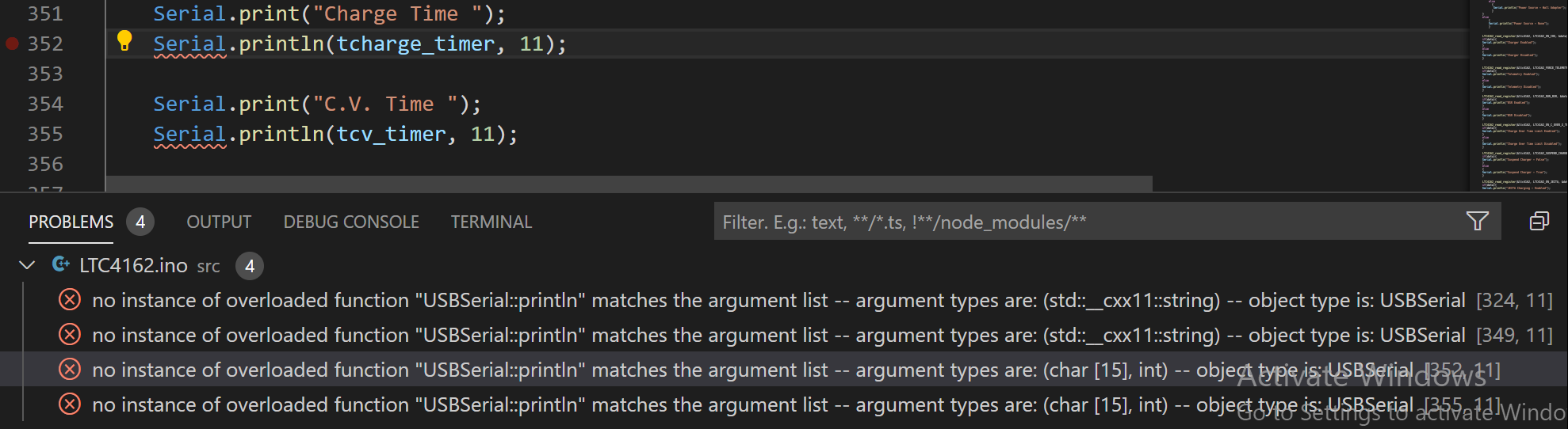

I’m adapting some code that was built for the ESP32 and I only have these 2 compile errors left that I need to tackle and I’m needing some help.
Here is the error I’m getting which also has to do with trying to serial print a Char:

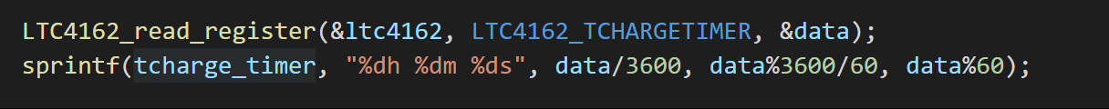

Here is the function that pushes data into the Char Variable:

For the first error, before you edited your post, you are using std::string instead of a Particle String. Changing to a String should resolve the error with the Serial.println.
For the second error, the compiler is informing you that there isn’t a form of Serial.println that takes in (char*, int) which is what you’ve got on lines 352 and 355.
Changing the call to Serial.println to just passing in the char array will work, provided that the string is null terminated.
So on lines like 355, simply do the following to print the char array:
Serial.println(tcv_timer);
Also, snprintf is safer than sprintf because you have to specify the maximum number of chars to write, preventing you from accidentally writing beyond the bounds of an array.

I added .c_str() to Serial.print String variables.
And just as you recommended I removed the 2nd piece of data when trying to Serial.print the Char variables and it works fine now.
