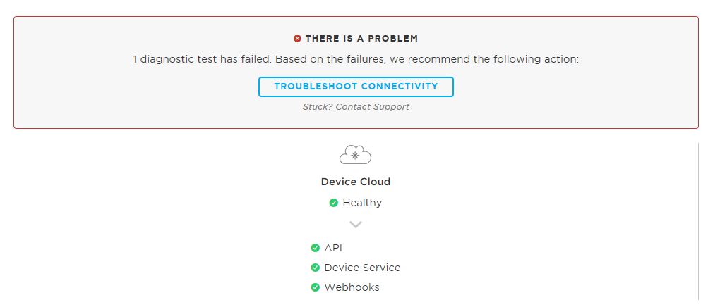

Some time my Boron lost the connection with the cloud led continue breathing cyan
I found with the command ping from console my Boron lost the connection to the cloud but after a reset with the button ping say device is online and connected.
In console I tray to do the diagnostic this is the answer:

Can you post the answer and let us judge wheter it's correct or not? (you can remove the device IDs if you want)
