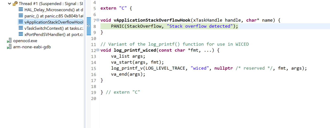

Okay cool, Thanks so much for your help. From that, I’ve managed to fix the compile errors and could get the debug firmware onto my photon. I have resolved my initial problem with a hard fault where a function pointer was not being instantiated within a library. However, there are a few more issues that I’m encoutering.
  1. Now I’m getting a stack overflow issue. This error comes up about 30 seconds after cloud connection. Apologies because I’ve never used Eclipse (or any debugging tool really) so I’m not sure how to tackle the problem. I’ve tried pausing it when the stack overflow happens and the photon begins to blink red, but the stack trace doesn’t go back far enough such that I can see what was happening before.
    In addition to that, when I select the previous calls in the stack I get the following:
    I’m not sure if this is expected.

With stackoverflow errors you may be initialising too many/big local variables or if you are running a function on any other thread than application thread (e.g. Software Timers), the stack might be too small.

How are you constructing the JSON? ArduinoJson can be quite heavy on stack.
The stack for the Software Timer's thread is considerable smaller than the stack for the application firmware - that's why constructing a local variable in the Software Timer callback may cause a stackoverflow which wouldn't happen when the same function was run on the application thread.
Also calling mulitple nested functions (call depth) on a thread with limited stack size may lead to stack overflow much quicker than on the application thread.

@ScruffR I think you’re right! I managed to narrow it down a bit. Here is my software timer callback:
void eventPublish(char *eventName){
    if(Particle.connected()){
        char pubBuffer[150];
        DynamicJsonBuffer jsonBuffer;
        JsonObject& root1 = jsonBuffer.createObject();
        root1["var1"] = version;
        root1["var2"] = product;
        root1["var3"] = wifiStrength;
        root1["var4"] = tem;
        root1.printTo(pubBuffer, sizeof(pubBuffer));
        Particle.publish(eventName, pubBuffer, 60, PRIVATE);
For some reason, the Particle.publish() at the end of my software timer call is causing the stack overflow. If I comment out that line, it seems to run fine. Although I don’t think thats the root of the issue. I think it has to do with the pubBuffer array. At the current value (150) it would cause a stack overflow but reducing it to 100 seems to run okay. I have other projects with the same concept of a software timed Publish and a pubBuffer of sizes up to 255 which seem to work fine. What would be the best way that you suggest to increase the available stack size? I could delete other timers, trim down the number of global variables, convert int’s that dont need to be that large to bytes. Sorry my memory management knowledge is not up to par.
The number of timers is irrelevant for that issue, since the individual timer functions are called one-by-on so their individual stack impact does not add up.
Global variables also don't impact the stack.
Reducing individual int to byte does also not make any difference since this 32bit controller will always align individual variables at 4-byte boundaries.
It's the thread that owns the stack and hence you'd need to increase the stack size for the timer thread to allow bigger functions to run, but I'm unaware of that API being exposed.
One thing you can do is to promote your pubBuffer to a global variable which can be shared among all timer callbacks since these are guaranteed to not interfer with eachother.
