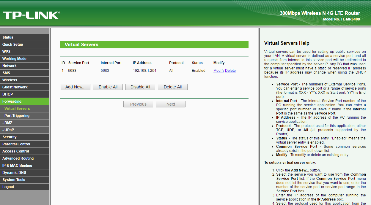

I checked my router I didn’t find any internet blocking settings.
