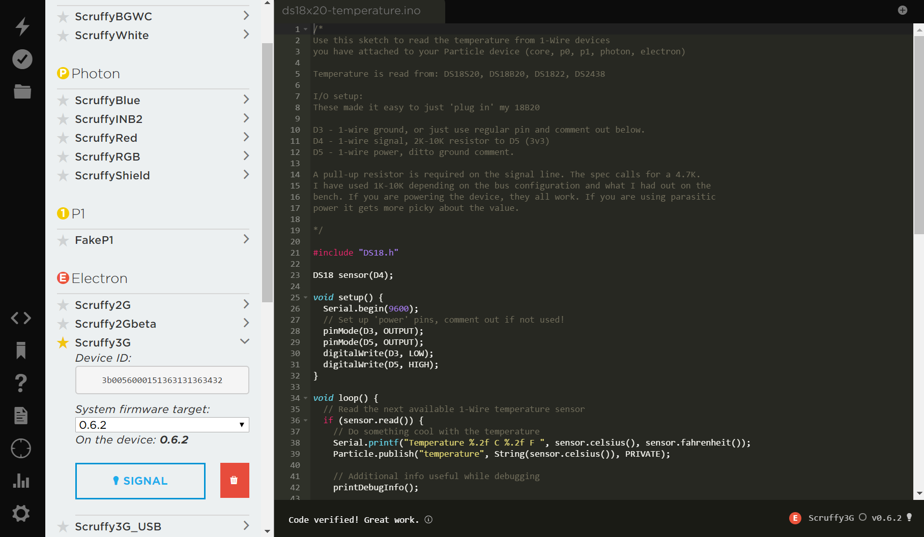

Can you post a screenshot of Web IDE with the target drawer open and the target device details shown?
I am using Windows and Chrome and this works each time (but only with recent version targets)
Try clearing the cache or use incognito mode.
Ok figured it out …I had to upgrade my Electron to 6.0 then everything compiled properly …This is one for the books thanks a lot for your help
