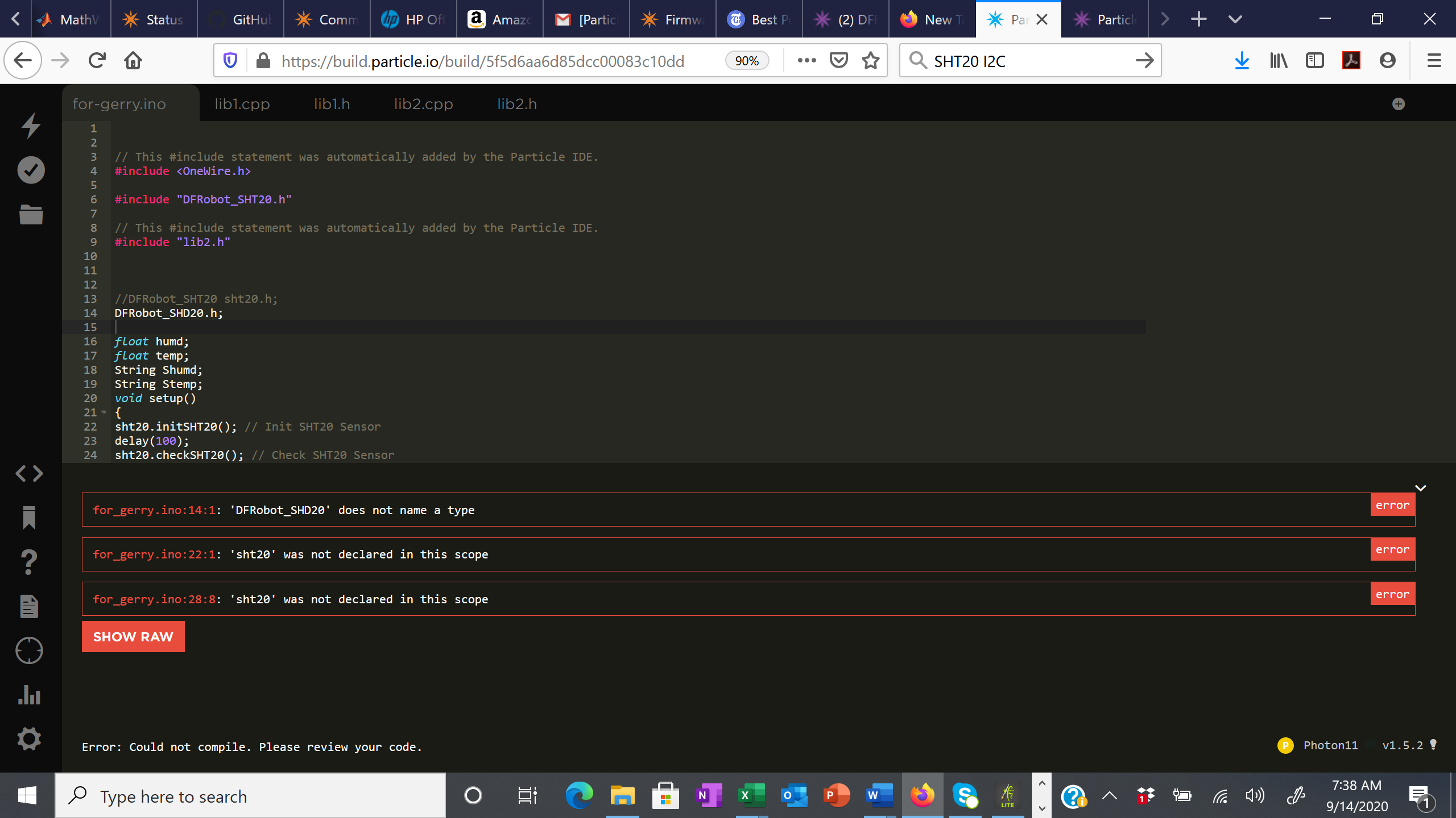

Thanks Rick but how do I do this? From your first reply DFRobot_SHT20 is not available as such in the community library. As I anticipated, merely typing
#include "DFRobot_SHT20.h"
over
#include <sht20.h>
does not do it (see below).

The compiler complains about that line
You cannot have a file name as an instruction.

Nope, I don't think they do.
I objected to the line 14 which reads
DFRobot_SHD20.h;
The other line in the image (line 13) is commented out and hence not impacting the build.
However, even if it was not commented, it would still be wrong as it contains a trailing .h
which the working line in your current code does not.
Otherwise, if you mean the `#include <Wire.h>' line, then I didn't really object to it but noted that it was not needed - I didn't say it was forbidden.
