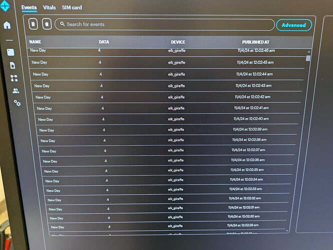

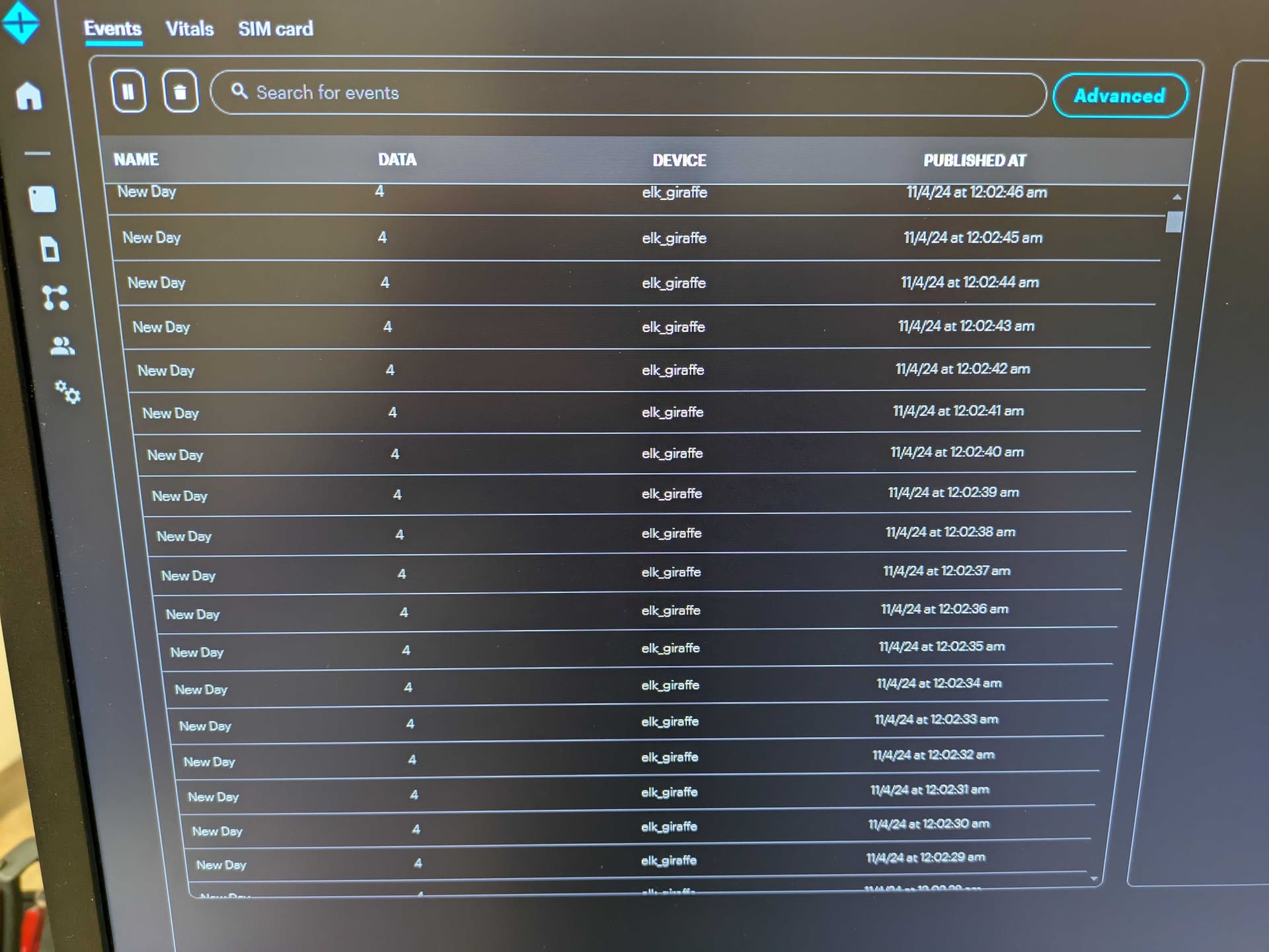

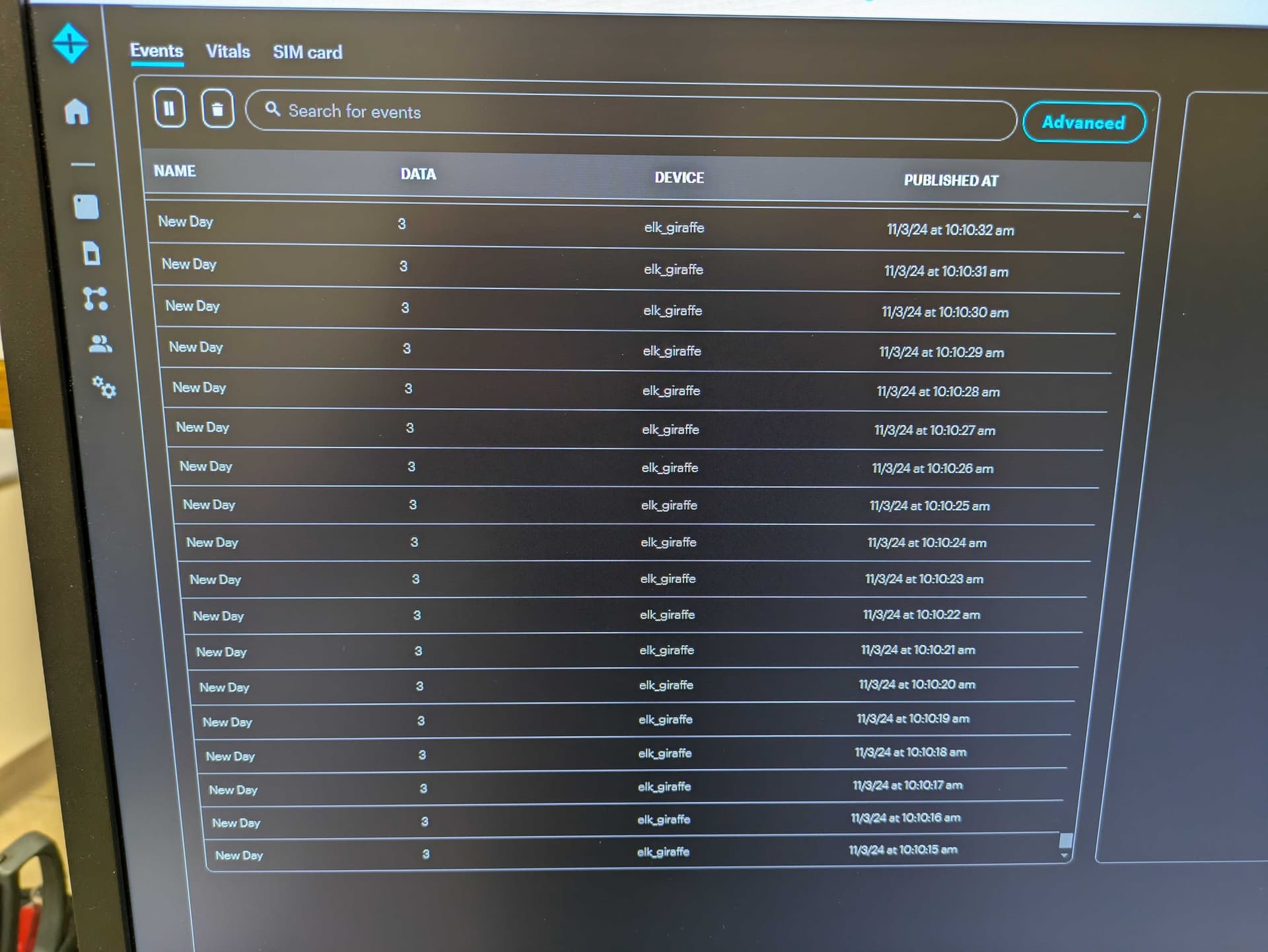

Recently on the 3rd almost all of our devices started spamming messages:
time_t now = Time.now();
 if (!nextDaily || nextDaily <= now)
            LocalTimeConvert conv;
            conv.withCurrentTime().convert();
            conv.nextDayMidnight();
            newDay = true;
            nextDaily = conv.time;
 if (isNewDay())
        publish(true, "New Day", "%d", Time.day());
Here is the code were using to determine if its a new day or not. Were using the LocalTimeRK Library, not sure if you would know anything about this @rickkas7
The spamming started around 10 pm on the 3rd and ended around 10 pm on the 4th. Were suspecting something with DST had to do with this and what the fix could possibly be

That is a great Idea, just to clarify though the spamming did stop at around 10pm (EST/DST )on the 4th, it normally operates as you'd expect, once a day at midnight (GMT).
