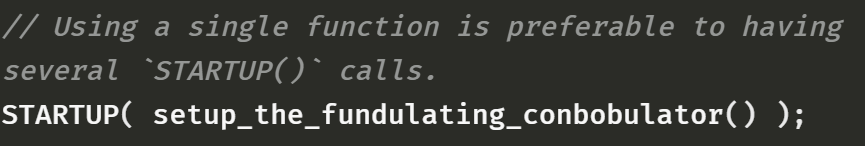

Also about your repeated STARTUP() calls.
Have a look at the docs
https://docs.particle.io/reference/device-os/firmware/photon/#startup-
