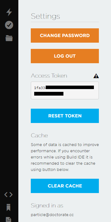

I used your code from http://jordymoors.nl/interface/ page, so I’m fairly certain it works. When I login to your page, I get what is shown in the screenshot below.
The URL works, it gives me the data back that I need, but I suspect to do it properly, I will need to execute it from within an HTML document and then capture what comes back for it work like your code below does. If I need to change the JS lib, I have no problem doing that, I was just going with what worked on your page. Also do I have to login if I use both the deviceID and Access_Token?
https://api.particle.io/v1/devices/4f004/lonlat?access_token=1fa33 (shorten to preserve the actual deviceID and
Access Token)
That's the important clue.
The login procedure requests an access token which will then be used for the next page.
So in order to have your own page do the same, you need to go through the login process just the same.
