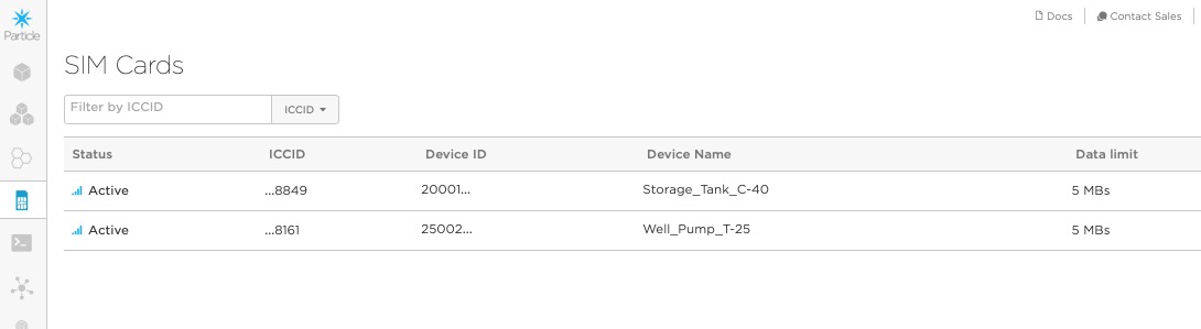

I have 2 new Elections that came with a 3 MB data allowance @$2.99/month (free for 3 months). But when I look at my SIM Cards in the Console, I am told that my data limit is 5 MB. When I go to View Device in the Console and click on SIM DATA USAGE I am told in one place that my Data Limit is 5 MBs but I have “3MB included/mo.”.
Can someone clarify: are the terms “data limit” and “included” synonymous - in which case, why the discrepancy between the two values - or does “limit” mean that I cannot use more than 5 MB even if I pay $.40/MB for everything over the “included” 3 MB? If the latter, I cannot find any explanation for such a cap.

The data limit is the amount of data you can use before your SIM is deactivated. Once deactivated, it won’t use any more data, and also is no longer usable. It will resume working at the end of the billing period or after you’ve increased the limit. It’s primarily used to prevent excessively large bills if something goes wrong and you end up using more data than expected.

The data usage is per SIM. There’s no option to pool data across multiple SIM cards.
Thanks Rick! How do I increase the data limit?

Log into the console, then the SIM Cards tab, then click on the … button, then Set Data Limit. Setting it to 10 MB would make sense in your case.
