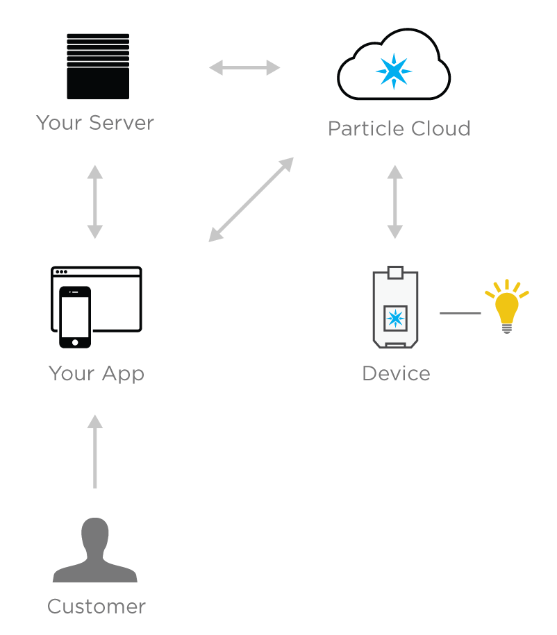

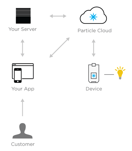

The first big piece to your configuration is that you have your own back-end server that manages your own user accounts. Great! We have an authentication option that works for this scenario, it’s called Two-legged authentication. The main idea here is that your own back-end acts as a proxy between your end-user application (mobile/web app) and the Particle cloud. You can read more about it here.
In short, your mobile/web app would manage user account signup/login/session, and each one of your users would have a corresponding “shadow customer” (customer with no password) in the Particle system. Your back-end would be configured with a Particle OAuth client that could generate scoped access tokens for your customers’ devices.
