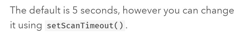

BLE.setScanTimeout(3000);

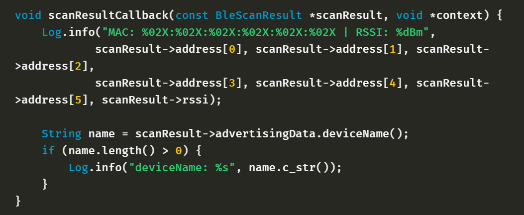

However, there already is an example in the docs that shows how to check the address. This can easily be modified to check the UUID.

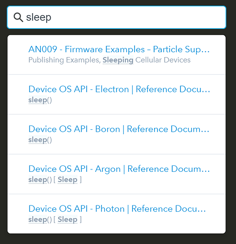

And also can u tell where in docs i will get to know about how to put argon in sleep mode and it's related info and implementation of RTC and interrupts in argon .
I didn't find the appropriate doc in the website, so can u please provide with the link.
Would be nice if you tried to find that yourself.
The docs do have a search feature and that will help finding most things (without the need for someone else to do the legwork for you)

This is the example code shown there

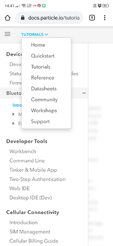

Well I can’t find where docs have a search feature i have looked a lot number of times but didn’t find that thing.
U can see in the pic i didn’t find the search engine anywhere in the docs.

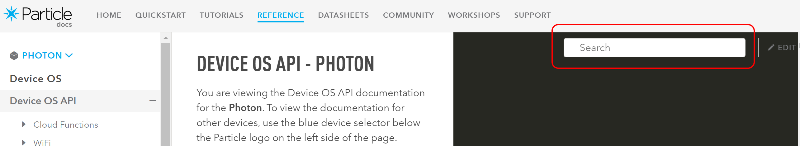

Have you tried landscape and/or desktop view?
On a desktop browser it would be in the right corner
Granted, not showing the search feature in on mobile browsers is a questionable decission. Maybe @marekparticle can chime in on that and forward this to the individual(s) responsible for the website design.

Well yeah okay In desktop view it shows and i found the docs i am looking for.

Good call-out. We only have a mobile search bar on support.particle.io (which can search the entire site), but that’s pretty opaque. Thanks for bringing this to my attention!

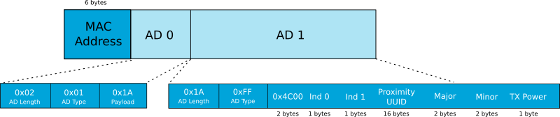

payload of custom data is the Manufacture specific advertising data which contains bytes of company identifier bytes(0x4c00),advertising indicators (0x02 & 0x15) ,UUId, major, minor, power
The advertisement packet contains the Bluetooth MAC address and the payload. The payload is composed of two AD Structures, the first one(AD0) gives generic information using the Flags Data Type, and the second(AD1) is the Apple specific iBeacon information.--Manufacture specific advertising data

    BLE.setScanTimeout(50);
