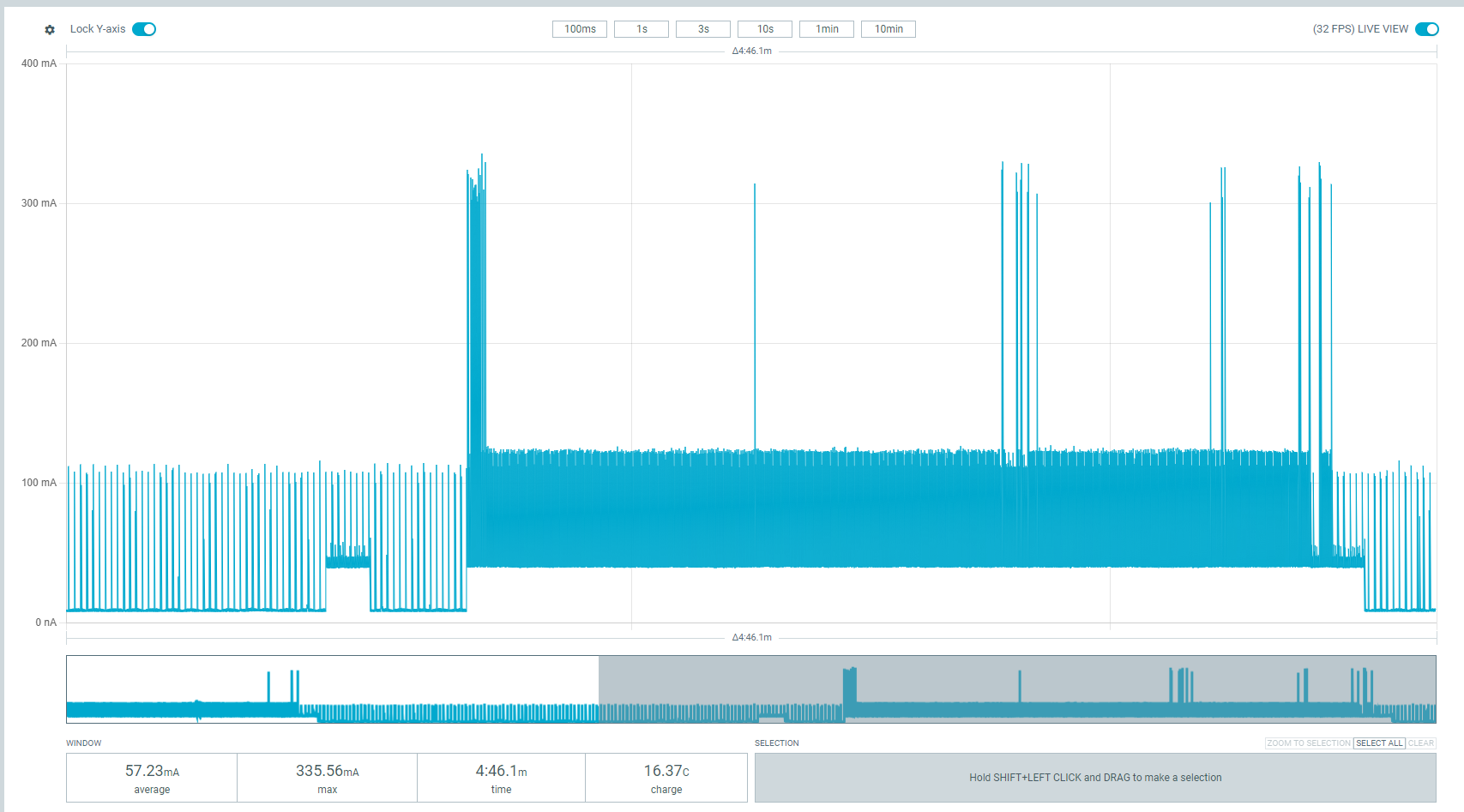

@ericpietrowicz, @no1089 Here are some additional test results at various device OS versions prior to OS 5.5.0. In short, I am able to replicate the behavior all the way back to device OS 4.0.0 and the issue is present for all device OS versions. In all scenarios, I've been able to call a particle function digitalRead() and it temporarily corrects it. In a smaller number of times, if I call a particle function when it's not occurring, it will induce it. will occur within 30 seconds of a cloud connect, sometimes it takes 15-20 minutes.
In some cases, I'm able to call a particle function when it's not happening and it induces it. This was at OS 6.2.1:
See trends below for each Device OS version back to 4.0:
** Device OS 6.2.1 (The latest and greatest):
  • Steady state current of about 8mA. This is expected having UPSV=1 per release notes from OS 5.5.5 and onward.
  • Still experiencing the significant increase and erratic current behavior:
  • In this case, it started by itself (not calling a function) and I was able to settle it down/stop it by calling a particle function.
Device OS 5.4.1 (prior to UPSV=1) running Tinker: Issue still present
  • Higher steady state current of about 40mA. This is expected due to no longer enabling UPSV=1 per release notes from OS 5.5.5

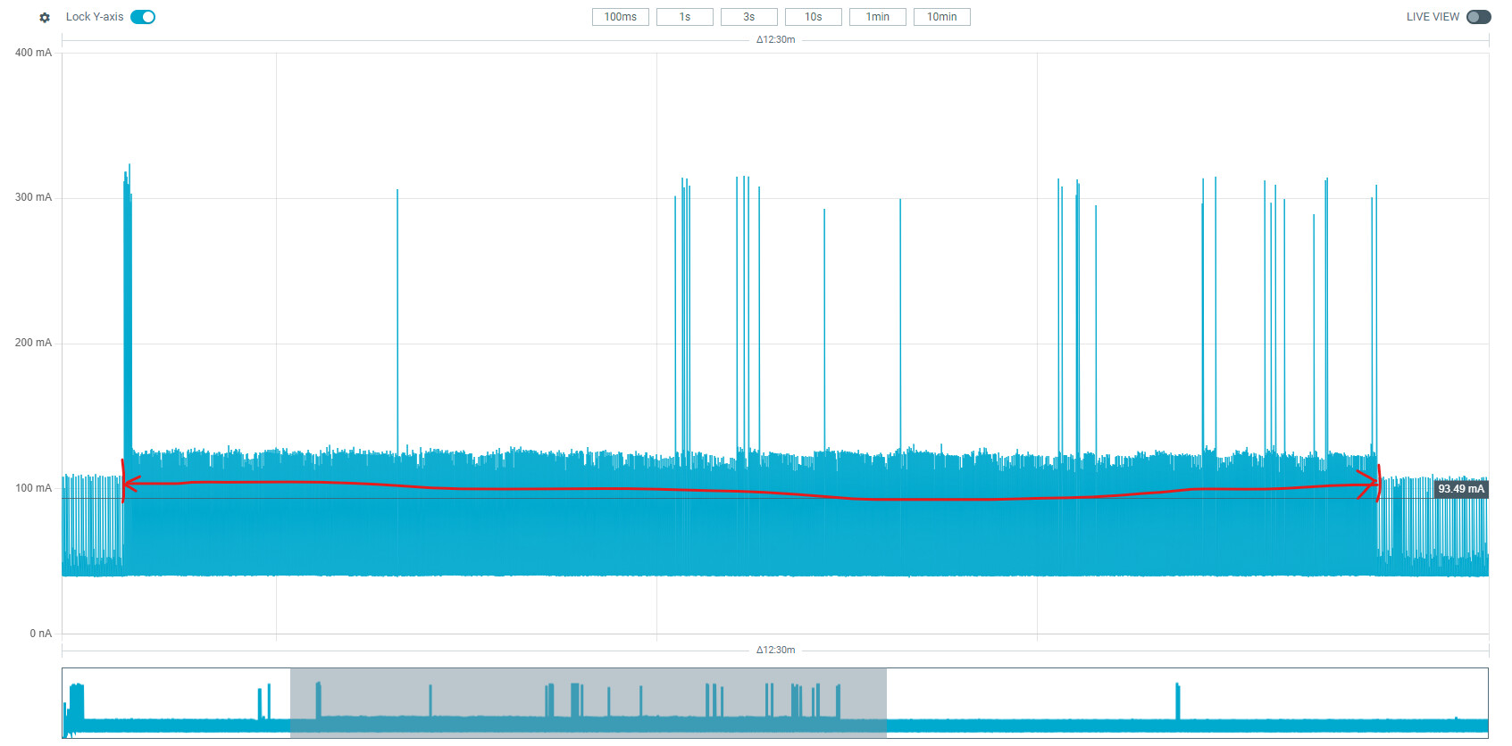

  • Did "Self heal" after 10 minutes of continuous high current operation

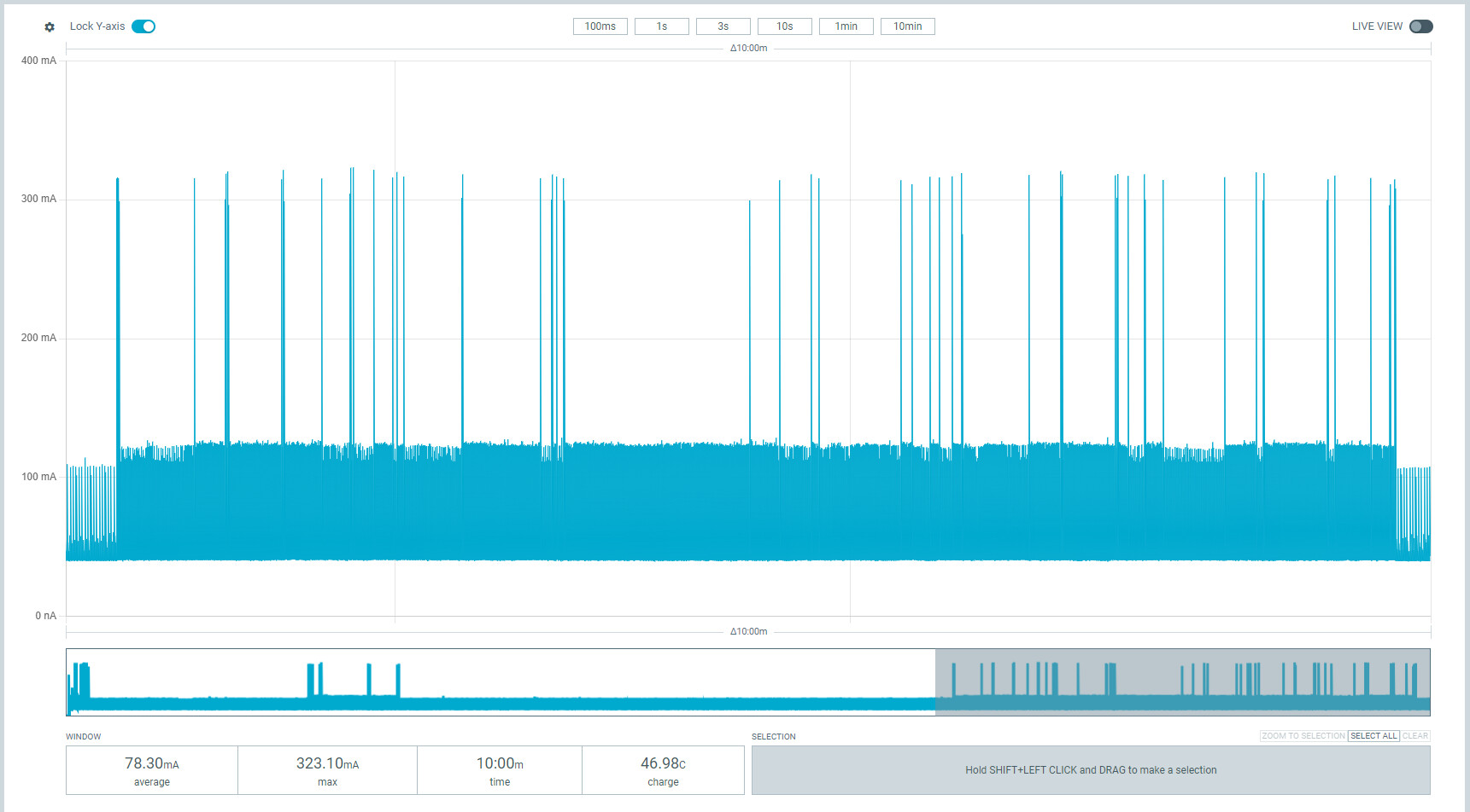

For reference here is what the zoomed in view looks like during the spike. Notice about 80mA on average.
Notice... a full 10 minutes of high current:
Device OS 5.0.0 Running Tinker: Issue still present
Screen shot from the Particle Console:
  • Higher steady state current of about 40mA as expected.
  • Did "Self heal" after 2:50 seconds of continuous high current operation
  • Was able to induce the high current issue by calling a Particle Function digitalRead(D7).

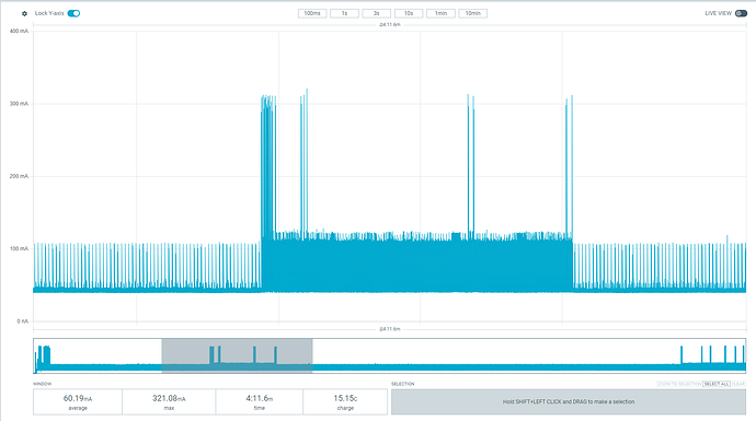

Event #1: Started itself and healed itself. Lasted for just under 3 minutes:
Event #2: Initiated by calling a particle function. Healed by calling the same particle function:
Device OS 4.0.0 Running Tinker: Issue still present
  • The issue that was observed started by itself and did not "self heal" after 5 minutes
  • Issue a Particle Function digitalRead() and issue stabilized.
  • This is the minimum device OS of BREN404X if I recall. So looks like this issue is impacted for all device OS versions.

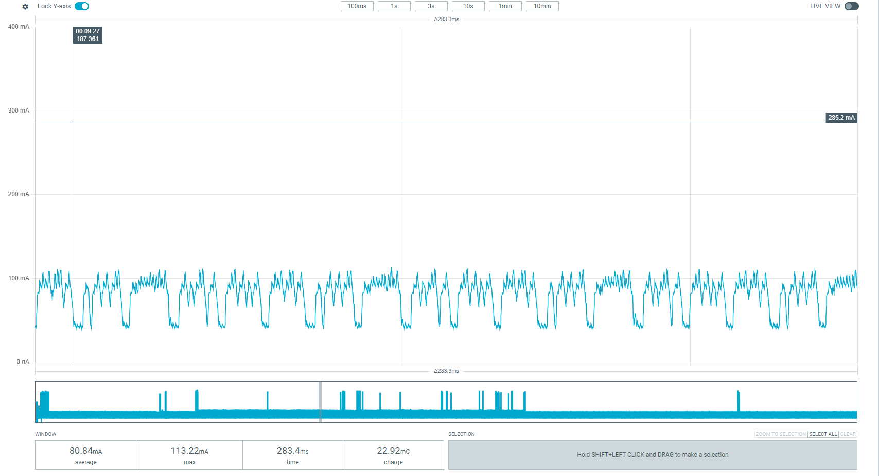

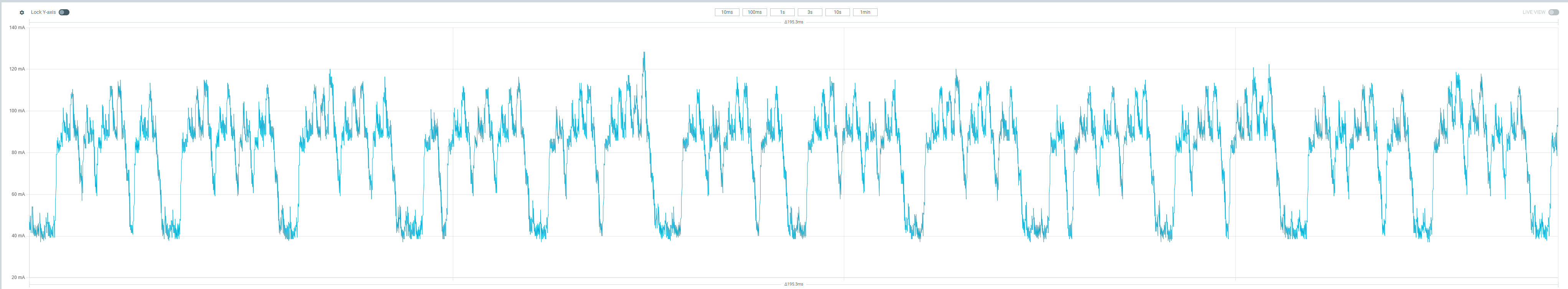

One other observation I'd like to share is during the periods of high current, there is some sort of cyclical pattern to it. It is about 62-64 hz (~12.5 repetitions in 195 ms). RF is black magic to me, but I wonder if we would see something on the RF side that matches this profile/frequency? Given the high current, the cyclical pattern, and able to impact it based on calling a particle function, do you think the radio is transmitting or receiving?
There is about 12 periods of the cyclical profile in this 195 ms snapshot:
Slightly more zoomed in:
By the way... I love the "Nordic Power Profiler Kit II". This thing is phenomenal in seeing/measuring current vs just that current ranger.
@ericpietrowicz, @no1089. I do love this Nordic Power Profiler... I don't know how I went without one previously.

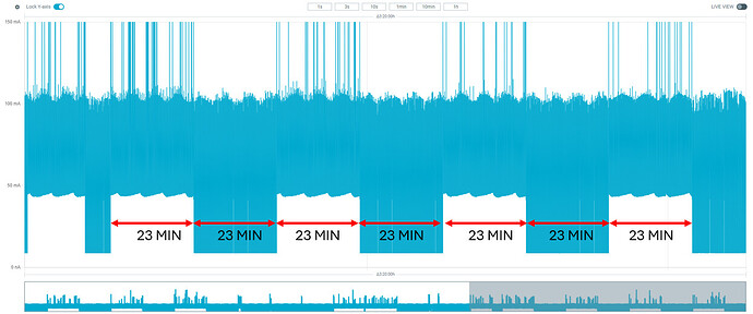

I was able to capture 8-9 hours or so. And in that 8-9 hours it transitioned in/out of the high current state roughly 11 times and was in the state about 50% of the time. It occurred anywhere from as small as 1 minute duration up to 23 minutes in duration withe the majority of them occurring for just over 23 minutes. If I recall, 23 minutes is the keep alive time for the Boron and BSOM right?
This is about 8 hours worth and you'll notice periods of higher current for extended periods of time. Notice, the extended periods of time seems to repeat:
The vast majority of them were nearly exactly 23 minutes in duration. Here are a few examples:
Start End Duration
12:16:00 AM 12:39:30 AM 0:23:30
1:02:20 1:25:29 0:23:09
1:48:20 2:11:26 0:23:06
7:17:37 7:40:45 0:23:08
8:03:37 8:26:47 0:23:10
At times, it gets into a cyclical pattern of in/out of the high current state exactly at 23 minutes:
My guess, is it's doing a keep alive message every 23 minutes and just like calling a particle function, any traffic on the cellular modem will induce a high current state if it previously was in a good state and vice verse if it was in a high current state it will put it in a low current state. Since this is the Keep Alive it further indicates it's the R510 cellular modem.
