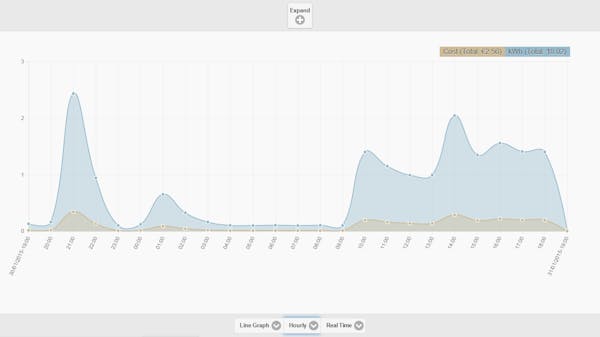

https://particle.hackster.io/yleguesse/spark-non-invasive-smart-electricity-meter
