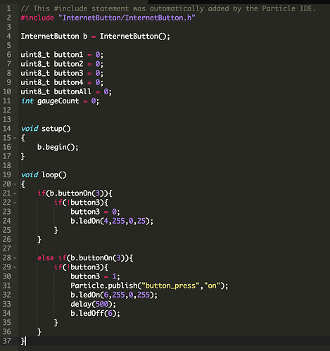

Hello,
I’m having moderate but not complete success with an app I’ve written.
The app should flash LED 6, unless I press the corresponding button 3, in which case it stops the flashing cycle, emits a different color during the duration of the button press, and publishes the state change.
I think this is a pretty basic question but my code doesn’t seem to work:
also, should say b.led(6,255,0,25);
Right now when I run this software it doesn’t seem to run the first part of the If loop
I’d rather say the else if() can never be true since else is only ever the case when the if() is not :wink:
If you replace the else for an inverse if() your else if() would read like this
  // reworded else if
  if ((b.buttonOn(3) != true) && (b.buttonOn(3) == true))
    // this will never happen ;-)
    // unless you are exceedingly quick to switch the button between the two function calls ;-)
I see what you’re saying. So my pseudo code of:
####If button state is unpressed, Light up LED color 1
####If button state is pressed, Light up LED color 2
is impossible to execute?
I’ve only really done Matlab and a bit of Python, never any hardware interfacing like this, so I’m not sure how the logic should work
It’s not impossible but the way you’ve written it is not working.
You’d rather want something like this
  if(!b.buttonOn(3))
    button3 = false;
    b.ledOn(6, 255, 0, 25);
  else if(!button3) // else already implies b.buttonOn(3) == true
    button3 = true;
Your if and else if have the exact same content in them.
