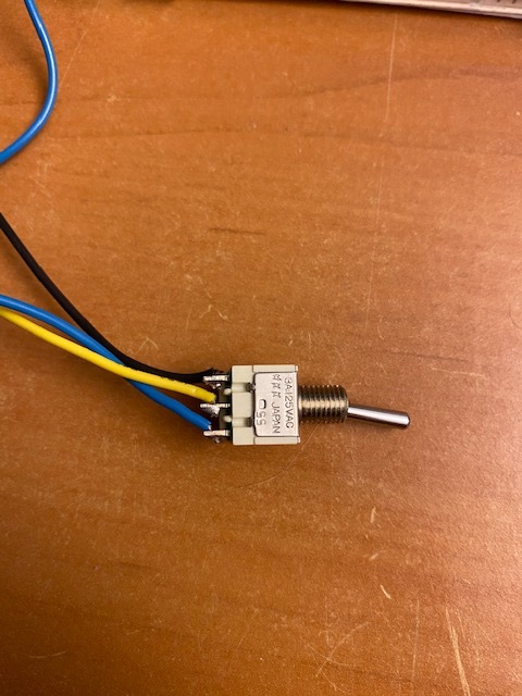

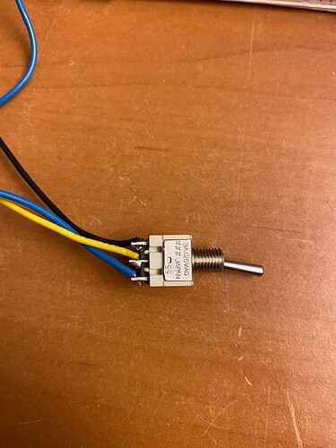

Hello
usually I always do a small flowchart to better understand where I want to go, this time too it has been done.
I edited the sketch as suggested and it works fine with an on and off switch.
Your question:
what if the button was pressed again while the timer was running?
With the switch works, it turns off and does not turn on again, while during the test with the buttons it turns on again after the set time has elapsed (Timer timer [2] = {Timer (1000, CentrOff, true)).
Attached is the photo of the switch used to better understand us.
However, I have to thank for the good help you always give me.
Regards
Valentino
