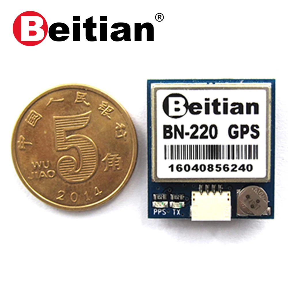

@jua23, I’ve used this module from AliExpress which works well with @rickkas7’s library. I power it using 3.3v without issues.
