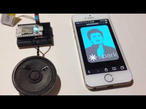

Check out the readme.md on github for all the details and source code:
Youtube video in action:

This is very cool. But my ear is twitching! I’ve not looked at the code, but are you rounding the frequency values to the nearest Hz?
What do you have perfect pitch?
The notes are defined as half period for each note in microseconds, output is bit banged with low level 27ns instructions, delayMicrosecond() is used, and the for() loop adds a tiny bit of overhead. I didn’t tweak the note times to account for this overhead but I do recall them being pretty spot on with my Rigol o’scope. If you want better timing, the built in tone() and noTone() are probably going to be a better bet I should re-write this as a proper library using the built-in functions!
Hehe, yes kind of - I’m a concert pianist, and a lead of a barbershop choir so I suppose I’m used to hearing stuff. But no fault of yours - you really have to work crazily hard to get electronics to play an accurate tone. But I’m really just pulling your leg - my jaw hit the floor at hearing this! Totally awesome!
So the Rick Roll tune I kind of found, but it was bad… and then I had to listen to the damn video over and over and try to fix the RTTTL notes to match it as best I could. Let’s just say that I’ve learn to love the song… lol. I can’t let it bother me or there’s no way I could have gotten this done! Key points: (1) Rick Roll everyone… (2) Enable others to remotely Rick Roll their friends and family… and enemies
