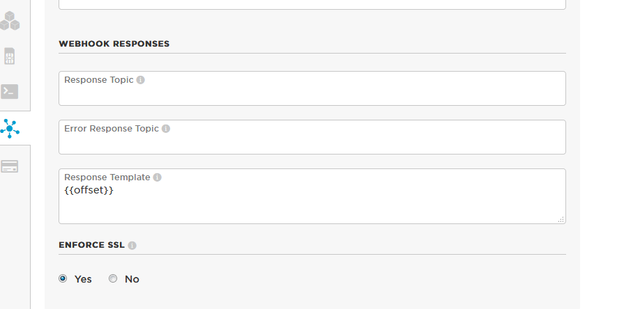

When I provide the coordinates manually in webhook url , I got my required offset i.e -7 from the response template. But my problem is I need to update the url with the coordinates of my photon device automatically. With the help google maps api i used to get the coordinates of my photon
device. In the 2nd screen shot u can see my location " locationCallback 12.924183,77.552666"
Can you please help me with this regard
It looks like you just need to replace the hardcoded coordinates in the URL field for the locationCallback webhook with {{PARTICLE_EVENT_VALUE}}.
https://api.darksky.net/forecast/6f.....c8/{{{PARTICLE_EVENT_VALUE}}
Thanks a lot @rickkas7 for your kind help. It works like a charm. I got the output what i want.
One more request @rickkas7 , how can I store or save the offset response value so that i can use that in my coding.
Yeah I figured it out finally. So no worries. Thanks for the kind help @rickkas7
