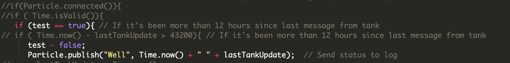

During frequent flashing of a variety of embellishments to my application, a block of code inside the loop (screenshot attached) executes immediately upon restart before a connection to the cloud is achieved. But during testing I discovered very strange behavior which I cannot explain.
The issue relates to lines 265 through 267. The Particle.publish statements are intended to populate a Google sheet via IFTTT, and they work just fine under normal operation. But if the 'delay' statement on line 266 is not commented out, the publish statement on line 267 executes upon application restart every time but the publish statement on line 265 never does! If I comment out line 266 as in the screenshot (and make no other edits of any kind anywhere), nothing gets published at all. Yet in both cases the rest of the code in the block executes because the relay closes every time due to the instruction on line 260.
The second attached screenshot shows a portion of my Google sheet "log" of events. Row 74 was added after a restart at 7:45:26 when the 'delay' statement was not commented out (the time stamp is missing because the associated variables don't get defined until a cloud connection is established). Another restart at 7:49:06, when the 'delay' statement was commented out did not result in an "auto on" event.
I added a Particle.connected() test at the start of the block. Thereafter, if 'delay' is not commented out, the 'auto on' event still gets published. When the 'delay' statement is commented out, things look normal, i.e. both publish commands execute (third screenshot).
Can anyone explain this? Can anyone think of a fix?
@blshaw45, couple of things. One is that I don't see lastTankUpdate being reset to Time.now() after if(Time.now() - lastTankUpdate > 43200) triggers. This would cause this test to trigger every time loop() gets around to it again. I assume somewhere lastTankUpdate is being initialized to Time.now().
The second thing is that you are likely hitting the max publish limit of 4 publishes within 4 seconds, explaining why it appears that your "Auto on" is not publishing when it is actually being blocked due to the publish limit. When the delay it added, the 5s delay effectively "resets" your publish count and things appear to work again. This is likely due to the issue above where lastTankUpdate is not being reset.

lastTankUpdate is intially defined as unsigned long lastTankUpdate = Time.now();
In the problem routine, it is reset 30 minutes after the relay operates, but you've made a good point that it should be reset earlier, probably right after the relay operation on line 260. Otherwise, the test for 12 hours will evaluate as true repeatedly as fast as the processor can run.
Right now the cell signal where I am is so poor that my test Boron can't reconnect to the cloud. Once (if) it does, I'll give it a try.
@blshaw45, when you initialize lastTankUpdate, Time.now() may not be accurate and could be set as soon as a Cloud connection is completed. It would be best to set it in setup() and make sure you are Particle.connected() and Time.isValid(). Also, I would reset lastTankUpdate right after the if() statement so it won't trigger again for another 12 hours.

since I suspected the issue was with my lastTankUpdate variable, I added a publish command to display the actual contents of both that variable and Time.now(). That code locked up the Boron too.
So I removed the Time.now() reference and the Boron was finally happy! So apparently I have been mis-using Time.now(). Any idea where I went wrong in that regard?
Look at your code just above the Particle.publish(). Instead of test = false;, you have test - false; which doesn't set test and so the if() statement will fire every time it runs. The "lock up" may be because you a) don't test for Particle.connected() before doing the publish and b) because you again broke the max 4 pubs in 4 seconds rule.

OK, I changed the 'test - false' to 'test = false' and it still locked up the Boron. Next I converted 'Time.now()' and 'lastTankUpdate' to strings in the publish statement. That worked, in the sense that it did not lock up th Boron. But, of course, what I see in the output of the publish statement is two strings of digits.
if ( Particle.connected()){
if ( Time.isValid()){
if ( test == true){
test = false;
Particle.publish("Well", String(Time.now()) + " " + String(lastTankUpdate));
You can format it through the Time class too.
Particle.publish("Well", Time.format(Time.now()) + " " + Time.format(lastTankUpdate))
That will give you more readable strings instead of the raw time int.
I just made that change (THANKS) and it gave me the following output:
Wed Oct 23 13:23:44 2024 Fri Dec 31 20:00:00 1999
Thankfully that demonstrates that the 'lastTankUpdate' variable has an incorrect date which is why the routine executes when it is not supposed to (always greater than 24 hours). Now I only need to figure out why since I have this statement in the setup() section:
That's because Time.now() is not valid during setup() in many cases, because the RTC has not been set from the cloud yet.
