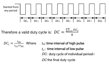

(My previous choice of water temperature sensor was one with PWM output, needing one I/O pin per sensor. Below is a sketch I made to read temperatures of 16 of these sensors with one Particle. I will adapt it to use the DS18B20 sensors.)

// In this function I'd like to integrate a "median filter":

  int nrPulses = 160;  // Even number: Number of HI+LOW pulses (Number of spaces in array)
  int periods = nrPulses/2;  // For this sensor, use a multiple of 8! (See datasheet)

What I did in my sketch is similar but much longer indeed: "Smoothening" the temperature measurements.
  • Collect a number of samples (High & low pulses) in an array (no calculations then not to influence the time measurement)
  • Total all high and low pulses from the array
  • Calculate the (average) duty-cycle with these totals

Some more explanation about the pulses I use in my sketch:
The PWM sensors I used earlier are outputting a continuous “pulse train” (4 kHz) and the Duty Cycle is proportional with the temperature:
I sample a few hundred “pulses” to reduce the error (increase the accuracy).
Hope this explains it sufficiently.

Q: Can you integrate the qsort function in the analyze() function so that the resulting temperature is a median average of the array values?
No tricks, just some experience.
Thanks for showing what the Pulses are, now I understand!!
So before we implement qsort() can we simplify analyse(), and maybe make it a bit more readable? Perhaps like this:
