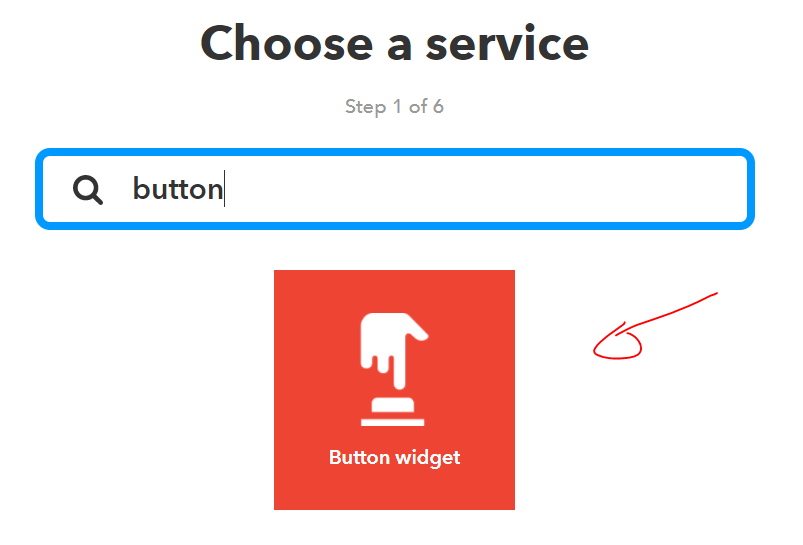

That's probably the issue. What you need, might not be exactly what others need, and thus generalized descriptions are given, for people to interpret as they see fit.
You need some kind of code on the device that opens the door on receiving the function call. How exactly that works depends on your hardware setup. Often, it's as simple as toggling a digital pin to switch a relay.
This is where you can choose, though a function might be the simplest at the moment.
Pick your device, and the respective function.

That is exactly the concise instruction I was hoping for!
I had seen the button widget, but didn’t know how to connect to the applet. So clear now.
