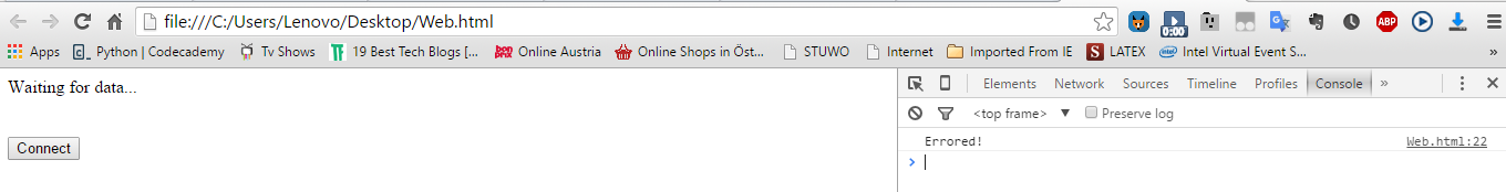

I used your examples but still getting Errored! on the chrome … any help ?
Sorry, but I have to ask: did you make sure to replace your credentials accordingly?
