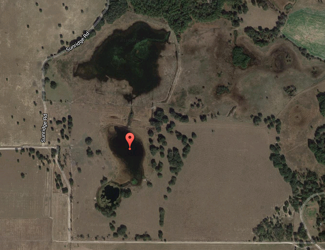

The format that I’m getting is DD MM.SSSS, is there a way to convert that to decimal?
I googled the formula, but it doesn’t work.See the pictures below its about 10 miles off.
Decimal value = Degrees + (Minutes/60) + (Seconds/3600)
If you put +28 38.5417’,-81 56.3664’ in to google you get the following decimal:
28.6483,-819435
The correct formula is DD + (MM.SSSS/60), If DD is negative then multiply by -1.
I believe you have a sign issue. The formula is DD + (MM.SSSS/60) but for all positive values, with the sign corrected afterwards. So 81 + (56.3664 / 60) = 81 + 0.93944 = 81.939944, then make it negative.
28.64236,-81.93994
Oh…yeah…I always forget the darn sign! Thanks for the catching that!

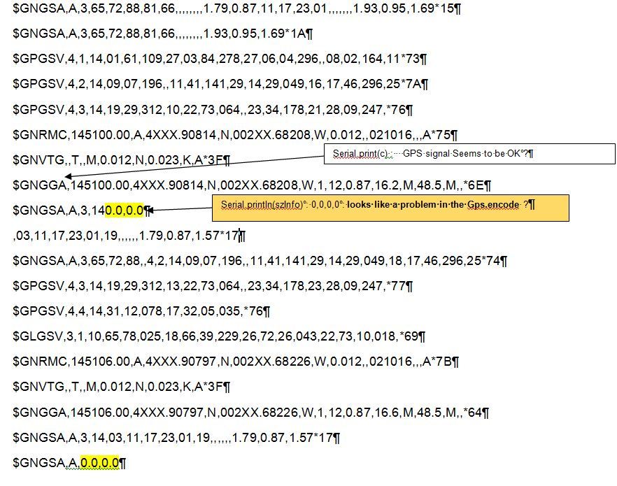

I have, like some others, a problem with TinyGPS giving me only 0,0,0,0 return.
For information, I use a Ublox M8N ( with only NMEA output done in U-center) and try to use TinyGPS on my Particle Photon 0.5.3.
As you could see, I very slighlty change the Gps.ino in the Web IDE, inorder to debug .( see my gps.ino)
I also found a good NMEA sentences ( I think ) , but I have still 0,0,0,0 for the “szInfo” ( see “putty.log” serial results )
I suspect a problem in the gps.encode in the TinyGPS.cpp that only return a gps.encode©= False, but I can’t find the solution .
Thanks, if you could help me .
