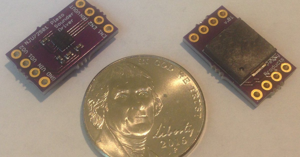

I picked up a few of these for testing and was just curious if it could play the Talkie library sounds, I’ll have to give it a try.

Tested the output with a Piezo speaker and it does not work at all.
Hi @RWB
My experience with piezo’s is that they have a very narrow band of resonance in which they sound which is usually quite high in frequency relative to speech (>1 kHz).
I would try a regular audio amplifier and speaker instead.
Yep, I used a speaker amplifier chip and it sounded great.
