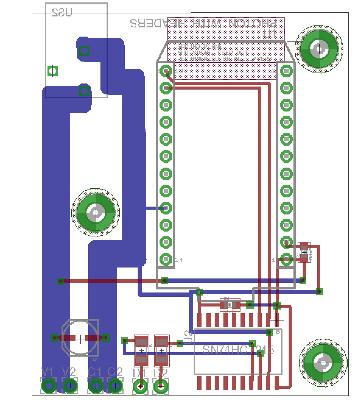

I just made a pull request to improve some of the stuff in your README.md
@peekay123 @bko Thanks for all the help I didn’t have time until now to work on this project but this is where I have the pcb now.
You must be planning on using two strips? I see two pins for data control, as well as power/ground.
I will mainly use one strip but I added another one just in case if some one has a big bed and they want to split it for his and her section. :grinning:
@Jean-Pierre, there are many items I would recommend cleaning up. I’ll list a few here:
  1. Many traces seem to be split into multiple segments by looking at the 90 degree corners. All traces need to be contiguous segments.
  2. I recommend “softening” the 90 degree corners with a 45 degree trace:
  1. Avoid meandering lines and trace misalignment, especially at the 74HC pads. The power trace you have angling up to the larger trace could simply go straight to connect instead.
  1. Any unused INPUTS of the 74HC245 should be connected to GND so they don’t float.
Thank you very much :innocent: should the input and output of the 74HC245 be connected to ground or just the output?
@Jean-Pierre, only unused INPUTS need to be grounded. This is done to prevent floating-input feedback which could cause oscillation and noise to be generated. :wink:
ok will do that.
@peekay123 would this be ok/work to ground the inputs
<img src="//cdck-file-uploads-us1.s3.dualstack.us-west-2.amazonaws.com/flex026/uploads/particle/original/2X/e/eb3ee123d29384f6a442a713bea35fb7345dda30.png" width=“690” height=“314”
