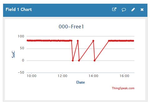

Capture
what can cause this wrong reading?

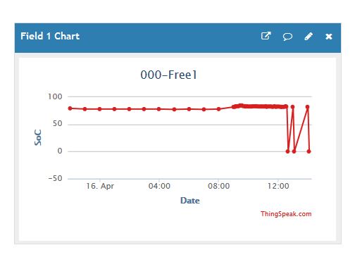

Capture
I’ve a solar panel connected to the Electron, could it be the cause?
It looks like you are missing Publish Events from the Electron during the times of “Zero” readings also.
Actually, it appears the Electron is sending the Publish more than 15 minute intervals (=4 per hour).
Your CODE doesn’t appear to function as you intended, and that’s likely related to the “Zero” readings.

Today again same issue, always around midday, when the solar panel get most of solar radiation. Is just a coincidence?
