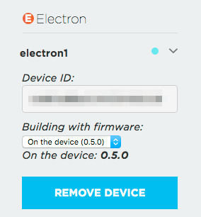

Make sure your Electron has system firmware 0.5.0 or 0.5.1 and if you are using Particle Build (Web IDE) the Building With popup menu says 0.5.0 or 0.5.1. The SLEEP_NETWORK_STANDBY feature was added in 0.5.0, so it will generate a “was not declared” error in 0.4.8.

But it still shows 0.4.8 in the devices page of build.particle.io.
How to check the current firmware version?
It is 0.5.1 now after removing and adding the device again.
