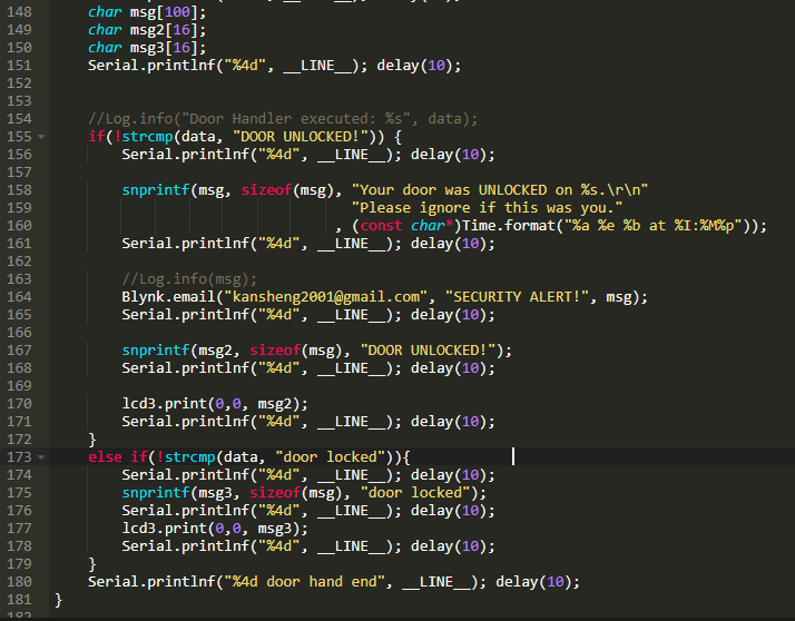

Hi ScruffR! Hmm very weird… last night i thought i had fixed the door handler crash … but now it crashes again even though i had the else statement added into the void handler.
Update - Upon reading on (!strcmp(s1,s2)) i found out that it means if(true),
https://cboard.cprogramming.com/c-programming/169955-if-strcmp-str1-str2.html
I tried changing to this line == but i’m still getting the crash at the same line, where the pointer stops at the closing else loop and does not fully execute the door handler function
if(strcmp(data, "DOOR UNLOCKED!") == 0) {
        Serial.printlnf("%4d", __LINE__); delay(10);
I’ve checked, my code editor line 26 matches the reference line printed.
  26 <-- reference line

For some reason, the crash now happens in temp handler - so line 148 and 149 does not execute… not sure how i can fix the lcd.print though it seems fine?

update … why is my crash going to door handler now!!! I don’t get it but i’ve tried coding it this way! I assign char msg2 and msg3 to print door locked and unlocked instead of lcd.print(string)

That assumption is wrong. Line 147 was the last line that was executed correctly! So the crash happens after 147 which would point to the issue being with the lcdX.print() statement. That also seems to hold true for the other crashes your reported.
There is little point in looking in what function it happens but rather look at what is common to all crashes.
Hi ScruffR! Hmm okay so it executes, and crashes… I don’t quite understand how I can identify what is common in these crashes, I do know that so far temp handler and door handler is crashing due to lcd.print…
Since WidgetLCD lcd3(V5) is a function, I can say my handlers are crashing due to excessive function calls aka recursive functions? So instead of calling the lcd.print inside my handler, I should try to break the function using return;?
Update, i tried to implement the return;but it still didnt work :frowning:
If this still are Stack Overflow (SOS+13) crashes I'd go with this reasoning:
Since lcd.print() works when called from setup() or another "top level" function it's safe to assume it's not the function in itself.
Since Stack Overflows can happen for reasons like a massive set of local variables or excessively deep calls (e.g. recursions as you said) and the point before makes the former unlikely I'd guess it's the latter.
Knowing that subscription handlers will be executed between loop() iterations or when Particle.process() is called (when not using SYSTEM_THREAD(ENABLED)), I'd guess the crash happens when the handler is called while your code flow sits somewhere in a nested call of Particle.process() (e.g. in softDelay()).
Since you have no control over the timing I repeat my advice to avoid delays of any kind and go with an entirely non-blocking approach like the one I provided already.
Actually not merely a function. This line of code instantiates a WidgedLCD object and calls the constructor of that object and subsequently you will call methods (functions in classes/objects) of that object instance.
Why should a random return statement change anyting?
Trial-n-Error is not the best approach - conscious reasoning usually works better.
For that you'd need a basic understanding of how functions calls work, how stack utilization works, ... and then in some cases like this some specifics about the inner workings of the Particle device OS.

void myAmbienceHandler(const char *event, const char *data){
    if(!strcmp(data, "Dark")){
        digitalWrite(D2, HIGH);
        Log.info("Led turns on");
    else if(!strcmp(data, "Bright") || !strcmp(data, "Dim")){
        digitalWrite(D2, LOW);
        Log.info("Led stays off");
