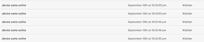

My WiFi router is really quite close to my Particle devices. The router is running in ‘G’ mode only. The channel is not congested. There’s barely any other WiFi devices attempting to use the network at the moment. Yet I’m still getting LOADS of this type of thing the past few days.
Any idea what more I can do to troubleshoot?
I’m slightly concerned that the Core, Kitchen, and a couple of other Cores nearby may somehow have got themselves connected to the AP a few floors up with the same SSID - but obviously different BSSID.
Wouldn’t they at some point ‘figure out’ that the SSID upstairs is not a winner and resume connecting to the nearby AP? Is there a way of managing all this? Have tried a forum search.
