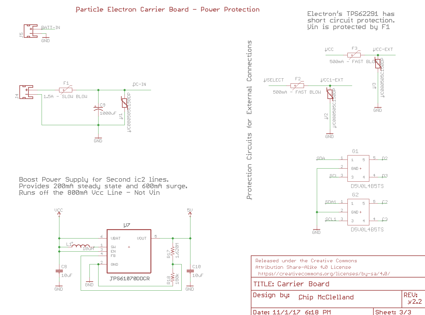

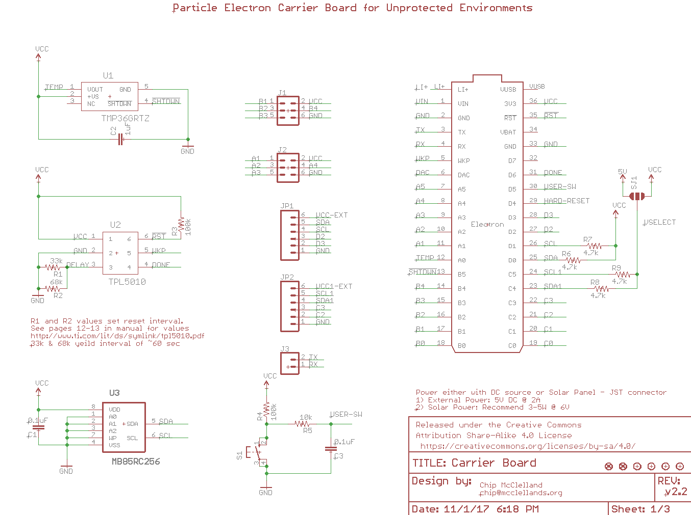

Schematics:
Page 1 - Electron and support chips
Page 2 - Power Control for switching both DC-IN and LiPo and supporting the “hard reset” feature
Page 3- Circuit Protection and the 5V boost converter for 5V i2c
blue
I think the main connections you would want to see are on page 1.
