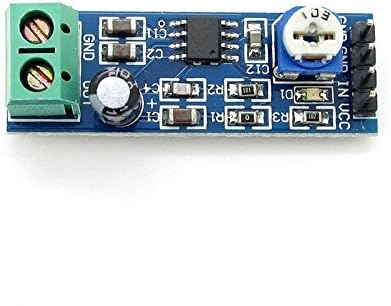

Can you also provide the exact type of your amp module?
Not sure of link allowances… This is the amp that I’m using:
