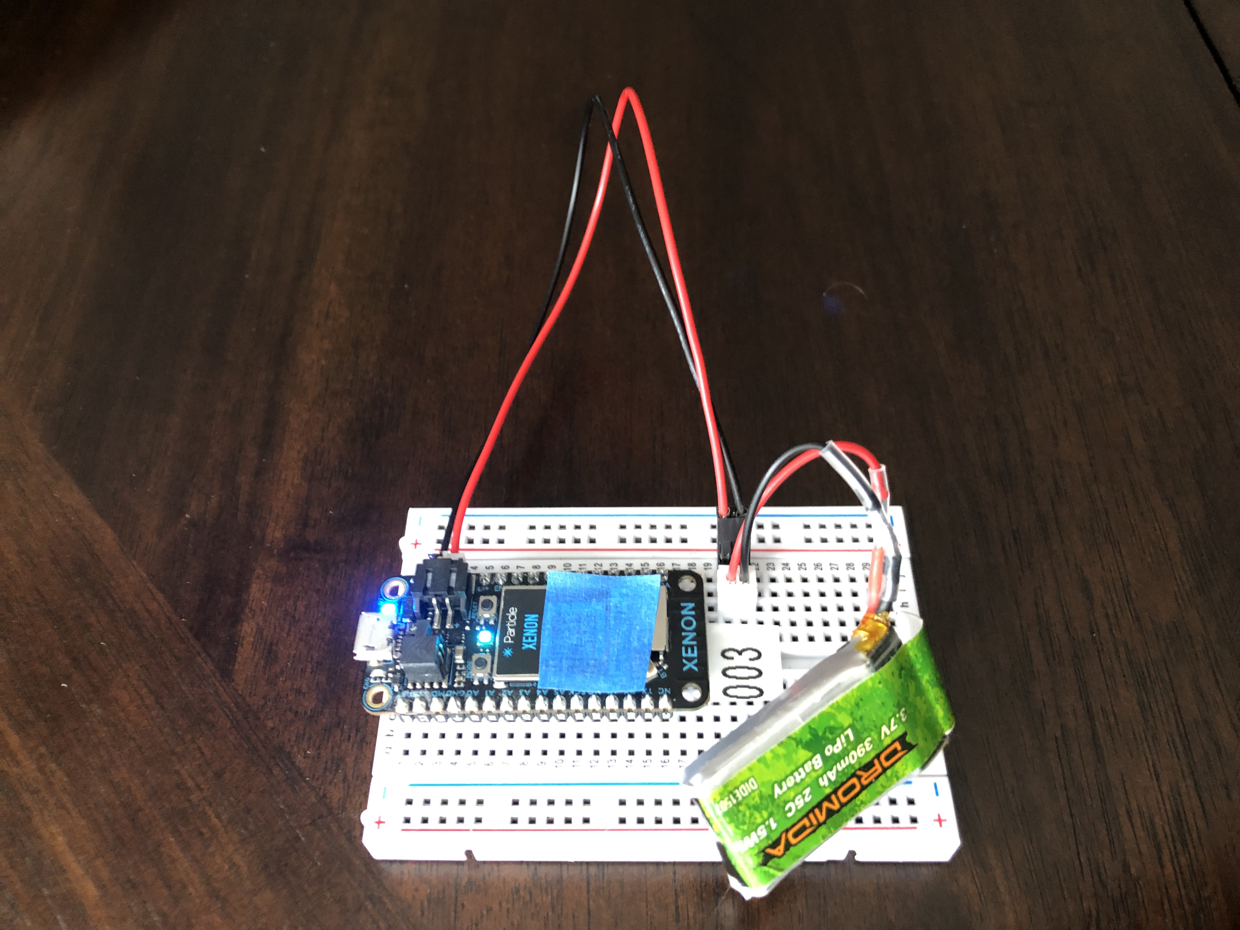

Right, as @ninjatill points out - make sure your polarity is correct.
The maker world (adafruit, arduino, particle, etc.) tends to put ground at the top/left.
The drone/RC hobby world (GNB, inductrix, happymodel, eachine, etc.) tend to put ground on the left/bottom - requiring polarity reversal before using hobby polarity with maker polarity.
Here is an example:
===start of edited clarification of picture based upon feedback later in this thread===
What am trying to show is that BLACK (-) must be nearest the USB.
You can’t tell from the photo but the drone battery’s attached JST PH2.0 connector, if plugged directly into the xenon, would have put RED (+) nearest the USB - not good.
So I made a short, 2 conductor, jst to breadboard jumper and reverse the two on the breadboard.
===end of edit===
Notice black (-) or Ground is nearest the micro USB connector.
The connector type is called “JST PH2.0” but you still have to make sure of polarity.
In the photo you can see that I had to reverse the polarity of a drone battery.
i guess the photo has been doctored a bit because it appears positive of battery is positive of device and neg of bat is negative of device which does not seem to be reversal of polarity.
No doctoring in the photo. What I was trying to show is that BLACK (-) must be nearest the USB.
So I made a short 2 conductor, jst to breadboard jumper and reverse the two on the breadboard.
ok, i get it now that the explanation has been added. i guess that’s why it’s called mesh for dummies cause obviously only dummies could have misunderstandings from the photo. :upside_down_face: thanks for clarifying.
I edited to clarify, thx.
