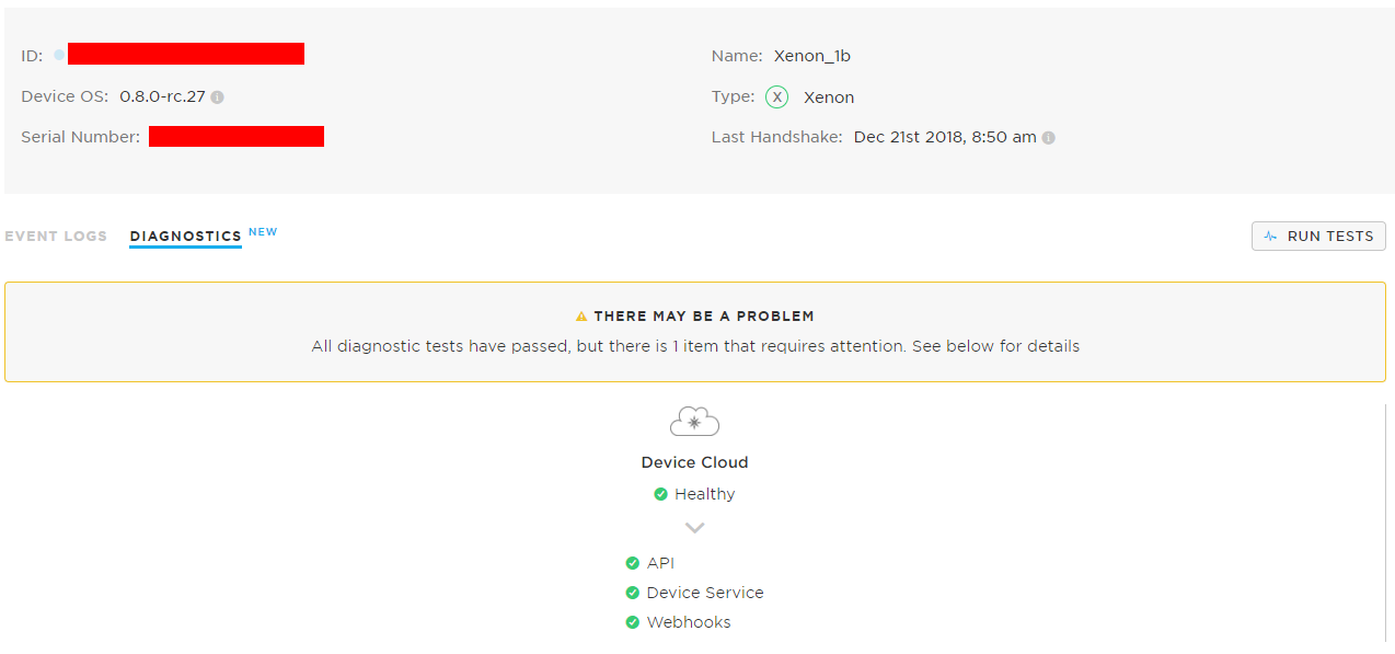

Xenon_1b accepted the update but i am seeing this in the console now:
Xenon_2a took the update but gives the same error above as Xenon_1b.

Finally after multiple (at least 6) DFU flashes I seem to have managed to get Xenon_1a out of safe mode and updated so for the first time since I got these devices, this particular unit, which has been the most problematic of the four, seems to be stable.
I just got Xenon_2b reconnected but I had to factory reset it, unclaim it and re-add it. At least the app seems to working properly now and it didn’t take ages to get everything set up like it did the last time.
Still I am hesitant to even start programming these with all the issues they’ve had and the mesh issues mentioned above.
