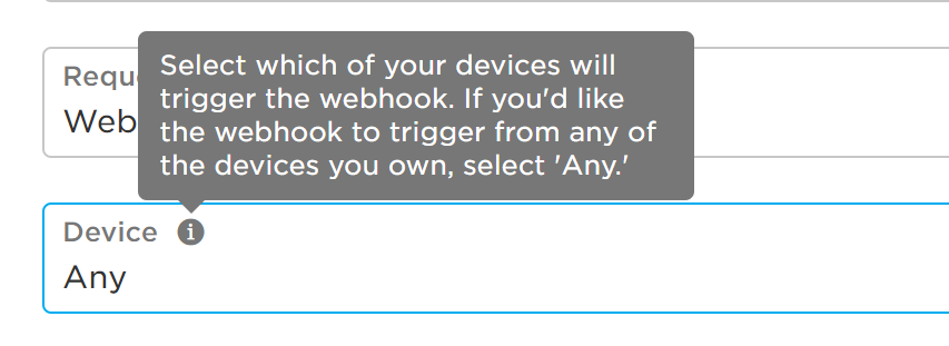

Yes, webhooks can be setup to only react to a specific device
