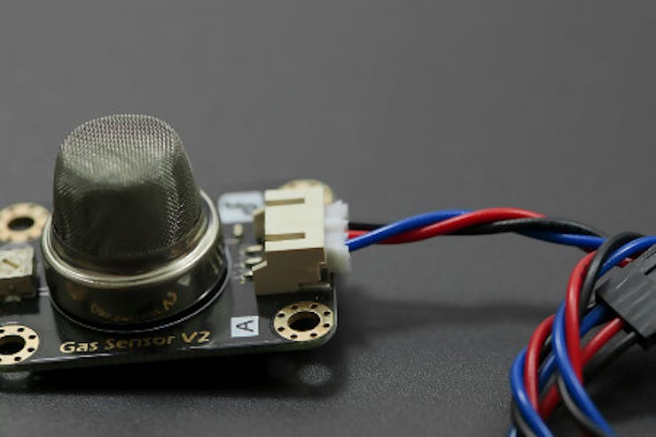

The gas sensor
I chose this one: Gravity Analog LPG Gas Sensor (MQ5).
The MQ5 sensor detects gas
The MQ5 sensor is used in gas leakage detecting equipment in consumer and industry applications. This sensor is suitable for detecting Liquefied petroleum gas (LPG), natural gas and coal gas. There is some sensitivity to alcohol and smoke as well.
The sensitivity can be adjusted with an on-board potentiometer.
It uses the standard Gravity interface:
“DFRobot Gravity Series is a high quality open-source, modular, plug and play electronics toolkit for everyone to create anything easily. With powerful expansion shields, various professional functional modules with standard interfaces and clear documentations, Gravity Series allows users of any skill level to easily connect and mix to realize ideas or develop projects.”

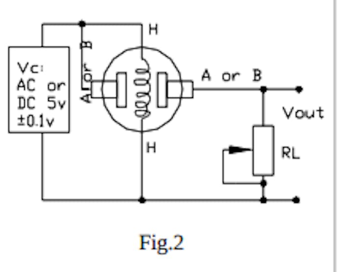

Since the analog inputs on the Particle device tolerate 3.3 Volts maximum and the sensor has a 5 volts output we need to adjust it.
peekay123 writes it well on this post:
“The sensor has an adjustable load resistor (RL) so you can adjust the maximum voltage output/sensitivity of the sensor. You can power the sensor with 5V and measure the output using a voltmeter (NOT connected to your Particle just yet). Adjust the trimpot to some safe value below 3.3V and then blow some smoke on the sensor to see how it reacts. Adjust the trimpot so the voltage never exceeds 3.3v. Typically, that would be around 4700 ohms or so. Once you are confident that the output voltage will not exceed 3.3v, you can connect it to your Particle.
If possible, disconnect the sensor entirely and measure the set resistance of the trimpot (RL). Then the formula
Vout = 5 * RL / (RL + RS) where RL is the trimpot resistance and RS is the sensor resistance.
You can solve for RS, giving (if I’m correct!):
Rs = RL * (5 – Vout)
Vout
You can then get the ppm from the datasheet chart.
MQ5 pot RL
Connection
NOTE: only once you have adjusted the output to max at 3v3, you can proceed with the connection.

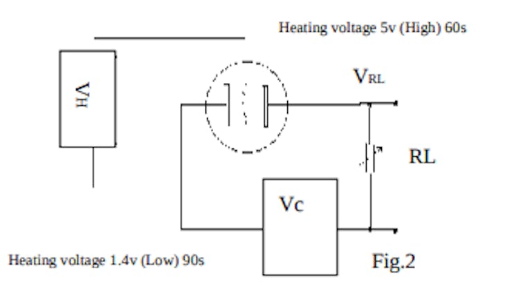

The MQ7 sensor requires switching its input power between 1.4 and 5 volts in cycles of 90 and 60 seconds respectively. This in turn generates a low and high temperature in the sensors internal heater.
From here:
“During the low temperature phase, CO is absorbed on the plate, producing meaningful data. During the high temperature phase, absorbed CO and other compounds evaporate from the sensor plate, cleaning it for the next measurement.
So in general operation is simple:
  1. Apply 5 volts for 60 seconds, don’t use these readings for CO measurement.
  2. Apply 1.4 volts for 90 seconds, use these readings for CO measurement.
  3. Go to step 1.”
Once everything is connected as in the picture above, calibrate the potentiometer until you read 1.4 volts and connect those 1.4 volts to the Normally Closed (NC) of the relay. Connect the Normally Open (NO) to Vin on the Particle device. The input of the relay must be connected to A4, so A4 as digital output will drive the 90/60 seconds cycle on the relay.
Finally, the output of the sensor goes to A1.
