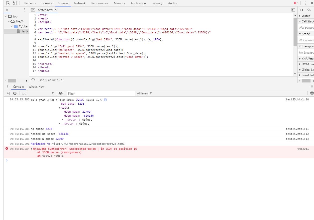

It’s definitely not a bug it’s a construction of your JSON as you can’t include nested JSON in JSON when the nested part is not a value of some key also using the same name for key/value pairs is bad bad bad as you can’t distinguish between the same mame of keys. Also when you build your key with space the access for the value of that key is not as easy as with construction with eg: underscore symbol “_”.
So even if JSON validator indicate that your JSON is valid:
it’s actually not, a quick js. test shows that your JSON is not valid:
