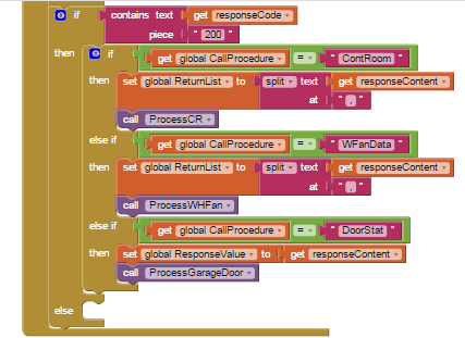

Now my code looks like this.

BTW, you might want to edit your last post to include an image of your MIT App Inventor code that's much bigger, so anyone interested in that app could learn something from it.
It’s not really that small, the forums made it that small for some reason.
I deleted it and re-added it back and it resized correctly :slight_smile:

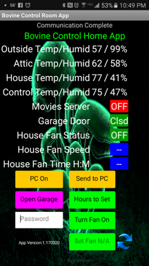

Here is a screen shot of my app that pulls data from 3 photons around the house.
And I can send data to them all as well.
