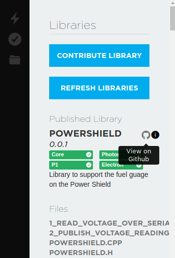

Step 1: Finding the GitHub URL
To find the GitHub URL for a library on the Web IDE, simply click on the GitHub Icon.
You will be taken to the library’s GitHub repository. Click on the “Clone or Download” button and copy the URL inside of the box.
