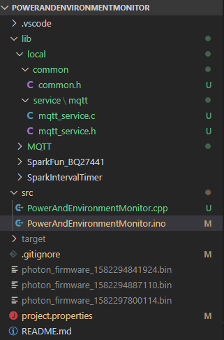

This is the project structure:
ProjectStructure
Which is the right way to include libraries and compile that on the cloud?

Is there really a backslash in that library path (service \ mqtt)?
That’s never a wise move, nor are blanks in a path.
Also the sub-folder local can be considered superfluous as lib already is meant for local libraries - cloud-based libraries would be referenced via the a dependencies entrie in project.properties and these also have precedence over local libraries when building in the cloud.
When sticking your libraries in their dedicated directories directly (i.e. ./lib/myLib/myLib.h) you would only write #include "myLib.h") and Workbench will find the library just the same.

The space between “service \ mqtt” is added by VSCode and it is only for visualization because the service folder now has only one subfolder.
I added the folder “local” just to separe my libries from third party libraries installed from the cloud.

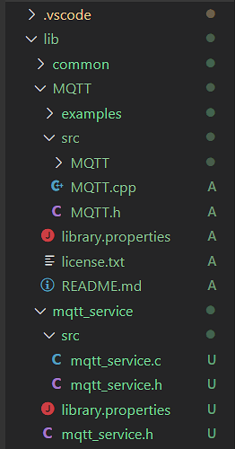

Hello @ScruffR,
I think I solved the problem partially.
I read the Library file structure and I adapted my library structure.
This is how my library folder looks like
Now each library has a src folder, a library.properties file and a readme.
When compile, I get a different errors.
Now the errors regards the include chain.
