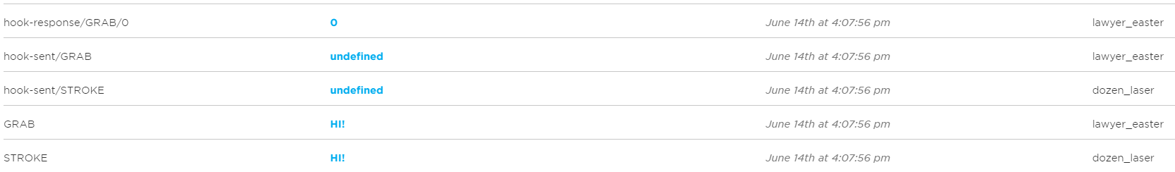

By checking the particle cloud logs we can conclude, photon 2 does NOT infact equal “HI!” to “HI!” (Seeing as “HI!” is beign returned and NOT “working”):
