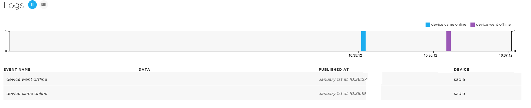

I have the code segment below that reads sensors between the hours of 13 and 24. Everything works fine looping around every hour. The problem aries at the end of the day because as the day progressed with the built in delays each hour the code is running a few minutes later in time so if I set the sleep at the XXXX point in the code for 13 hours the unit will not wake up exactly at 13 but the number of minutes that got delayed from the previous day. Eventually over a few days the unit is waking up later and later. If you look at a snap shot of my log for one period of time the unit came online at 10:35:19 and went offline at 10:36:27.
The next iteration the unit will come on two minutes later and so on and so on.
