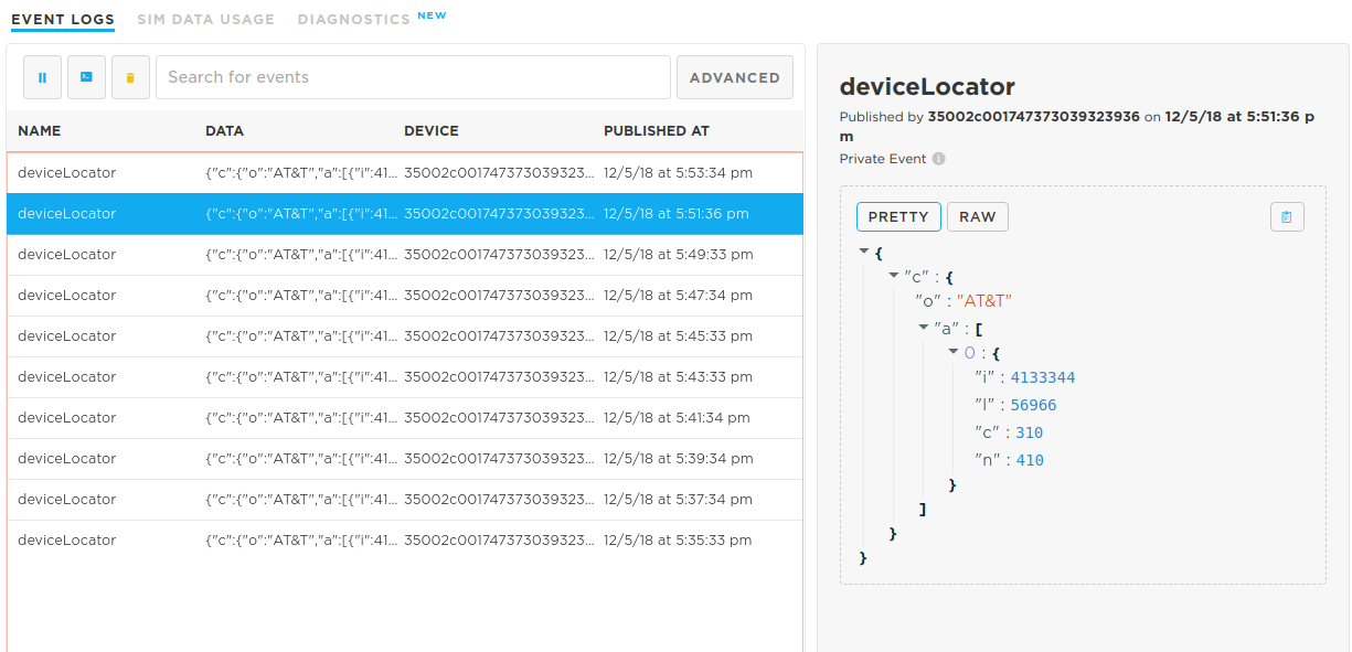

Here’s my event log;

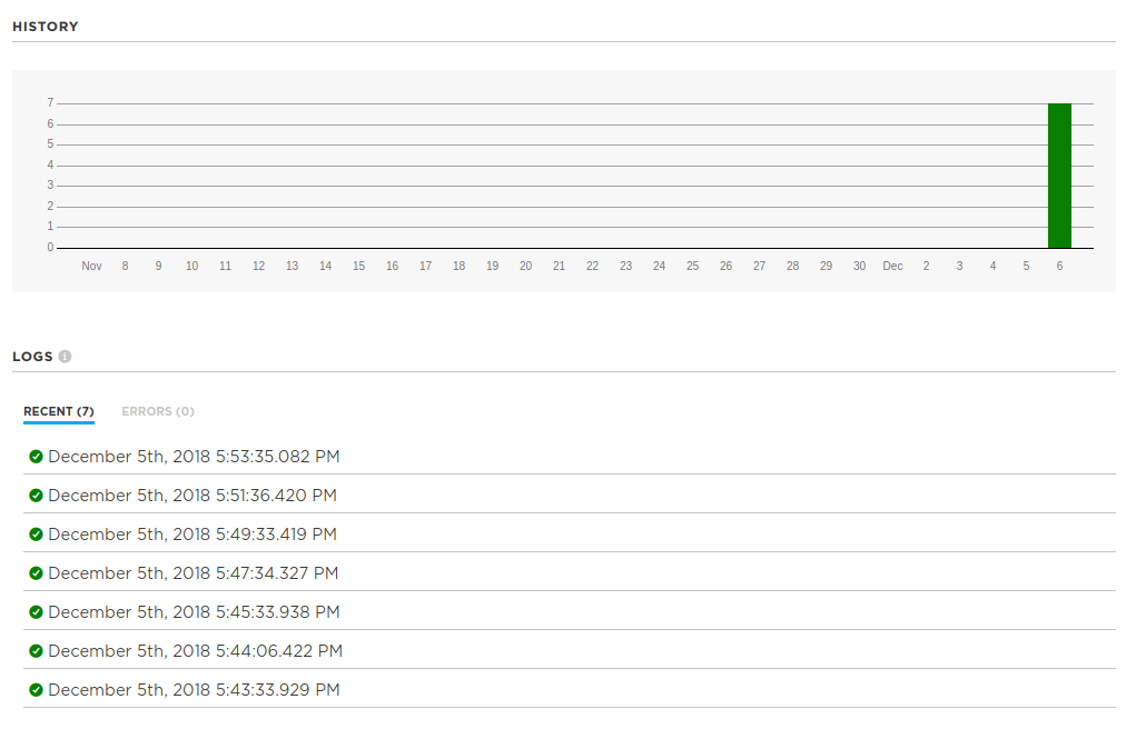

And here’s the Particle Console Integration monitor It showing every thing working smoothly.

But in your event log there are no webhook-response entries, so it seems your webhook isn’t triggered at all (or look at console.particle.io/events to see all events)
Could you also show the details of one of the recent calls in integration montor?
Double check your Google Maps integration at console.particle.io/integrations
