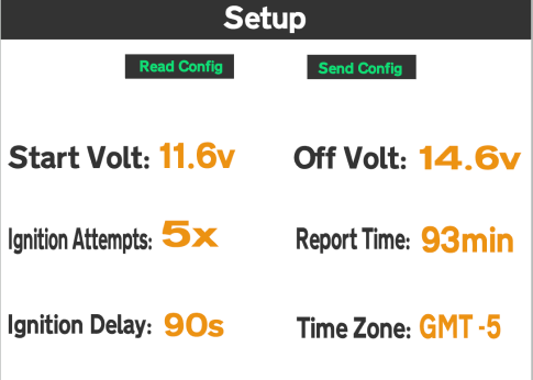

Okay awesome, so the Particle.function() command returns the value that is returned from the function? For clarity, I am trying to update certain setpoints and config values locally on the device from the cloud:
For example, this is what the user sees on their mobile device-
Bluhhhhhhh39
Where the read config sends a function to the device to send the config values currently stored, then they can change the values on their mobile and then send the config information back to the device. I didn’t know how the Particle.function() call handles these types of requests.
