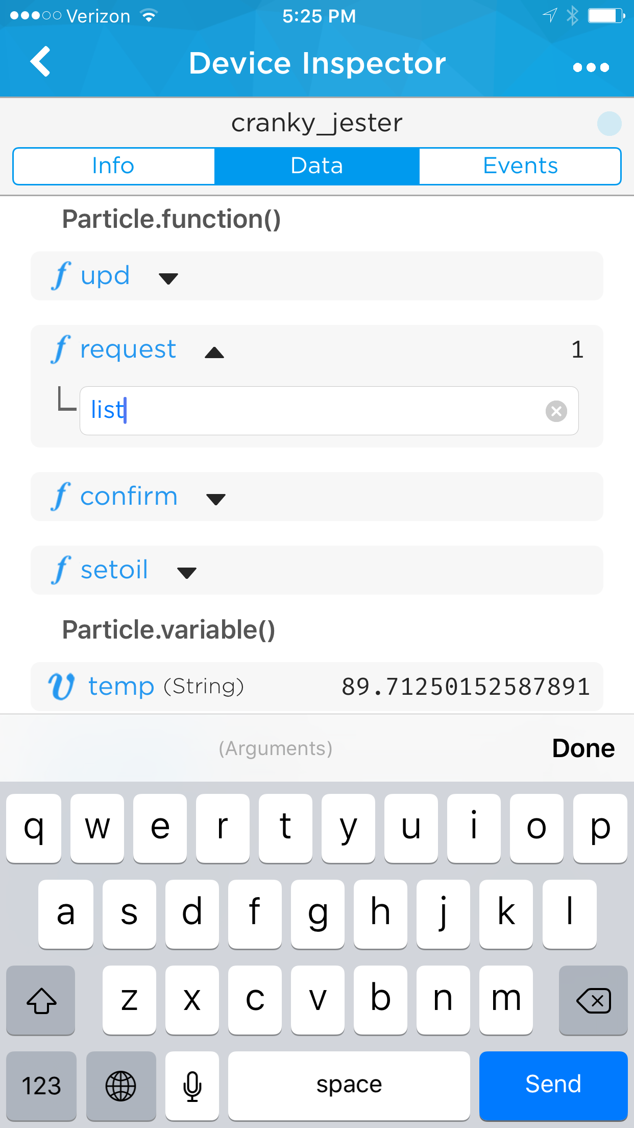

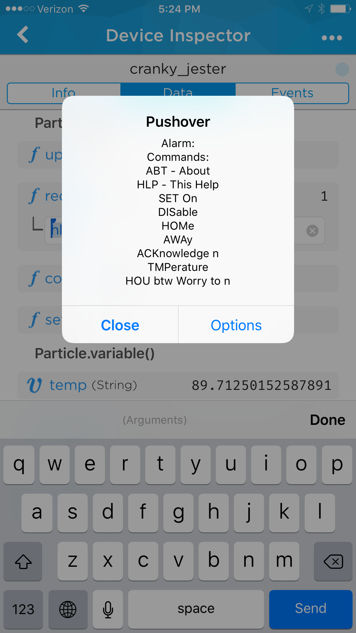

First Request Help, which lists all available alarm management commands:

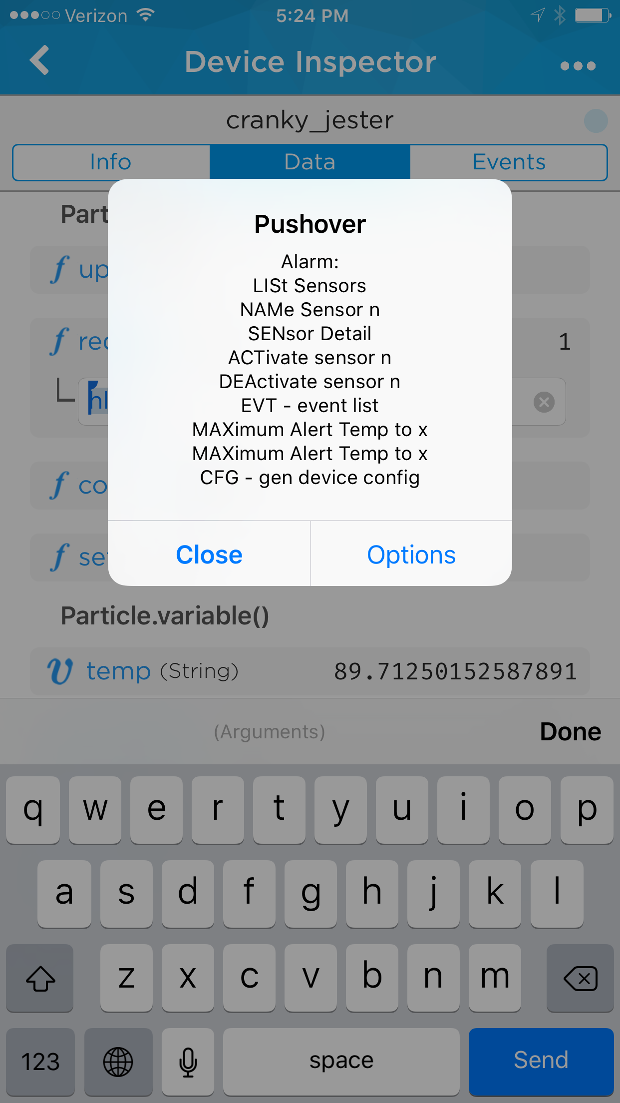

Responds with two Messages listing all commands:
Request a List of all system Sensors:

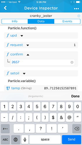

This Request requires confirmation with a Secret Number, presented here:
Confirm request with Confirm Function and the Secret number supplied:
And here is the listing of system sensors:
